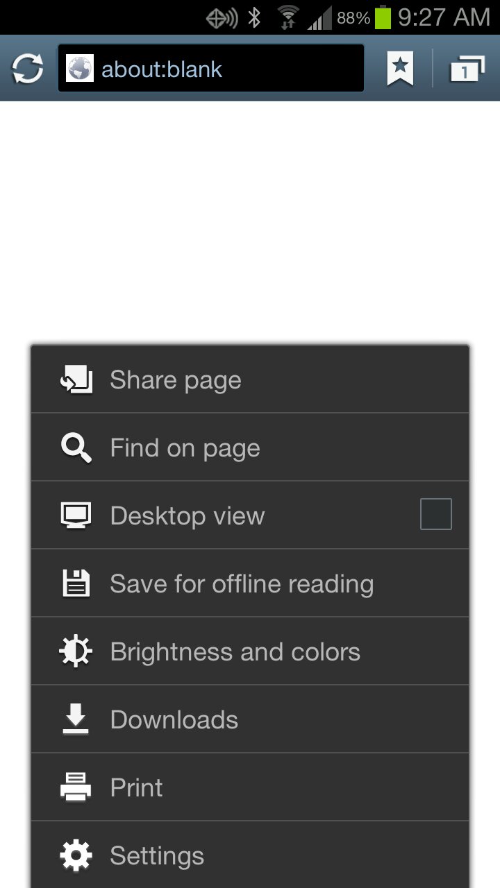

First of all make sure your power savings (notifications top) is turned off.
Go to internet (your browser) Click on the drawer (bottom left screen) scroll up til you see brightness and colors, choose default. Now you see clearly now. Ta Da
For you normal (non internet) settings use the settings
umm, no buddy. us att users do not have a brightness and colors setting on the browser (we may have had a brightness, no colors, setting before I dont remember. But it's definitely gone as of the latest update, hence why this thread actually exists). which you'd know if you read the thread.
You Verizon people have colors and brightness. And maybe other carriers I dont know. Not AT&T.
