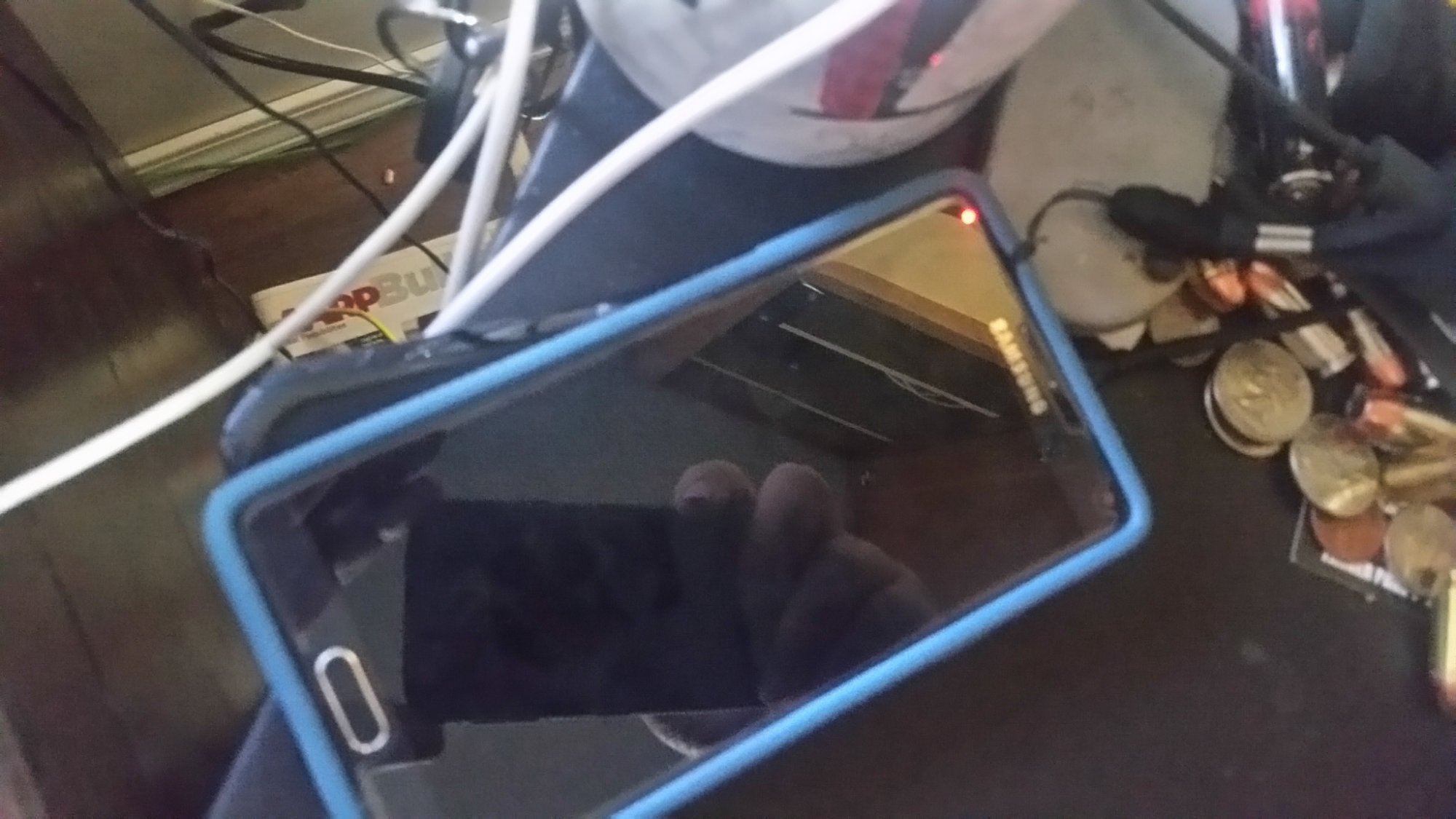

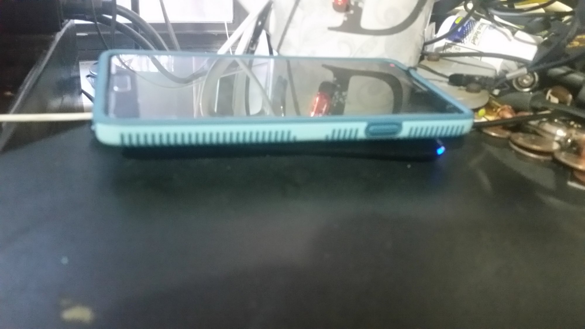

well, just now, I was using the phone and just up and dropped it on the table, it just happened to land crosswise and at an angle on the Qi pad.... A BLUE LIGHT !!!
I don't believe it, but there it is.... then I got to thinking, ya know, the Note 4 is a BIG device, and the battery is not in the center of the phone, it is on the Left side (looking from the front )
Wallah! Bingo! get the Wireless coil centered over the Qi pad ya little DumKoff .....
