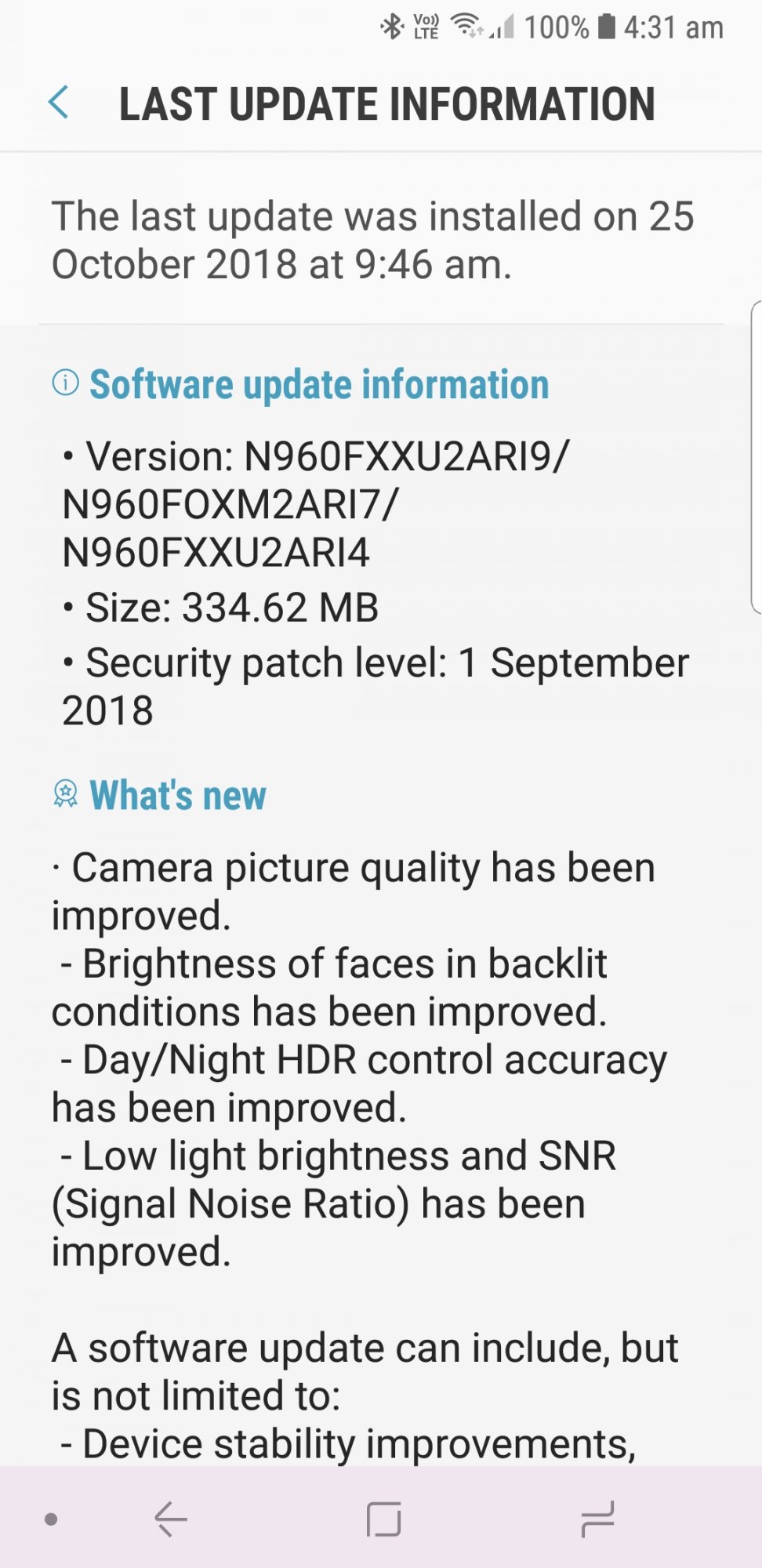

Yeh thanks for your reply, this was a usual update from both Carrier (Telstra Australia) and Samsung last week.
Download as usual. To improve the overall camera capabilities.
Don't really know too much other than just a regular update.
version 8.1.0 Samsung 9.5
So it's a regular system software update where the changes are mostly to the camera, but may include other things (e.g. if you were not already on the September security patch then there's a security update in there as well).
It's possible that the problem is not with the camera updates but with something else that was in that update. That doesn't necessarily bring us any closer to a solution, but I mention it because the camera itself might be a red herring (or not: there may be some interaction between the camera and this "call and message continuity", whatever that is).
