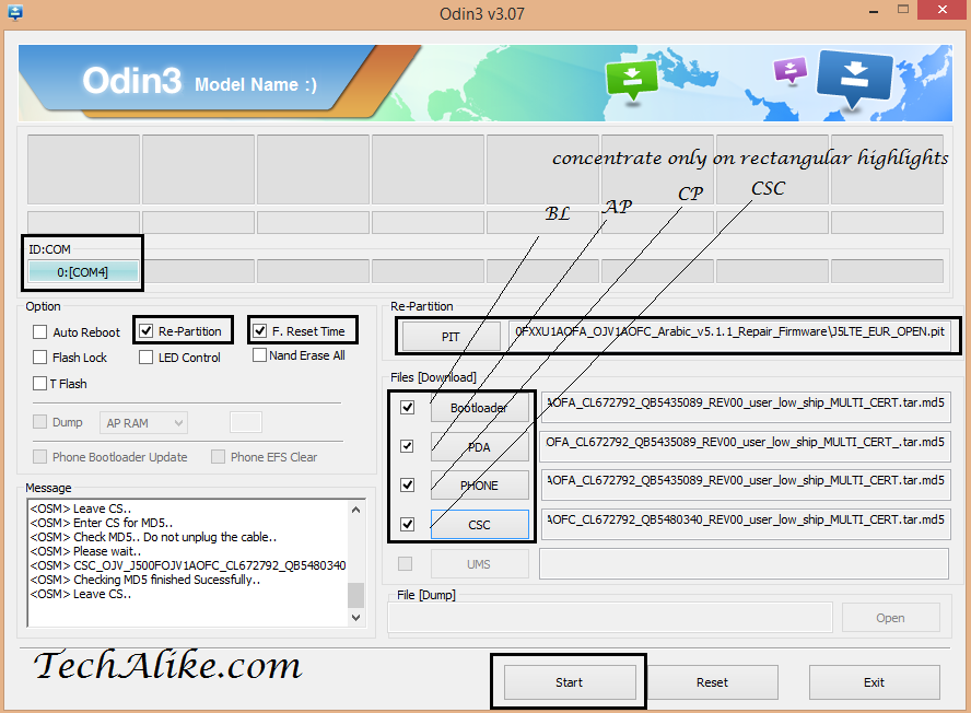

Step 4: Now below you will see a diagram of what you need to put in the fields the only one you do not need to fill is the "USERDATA" field unless firmware requires it, but isn't 100% needed
Source: TechALike
Now be aware in order to find witch one goes where each file that was extract has a initial that is displayed like this: "CSC,HOME, CP, AP & BL" the image shows on a older version of odin witch the S7 doesnt support so take the image with a grain of salt as its only purpose is to show a diagram here is what the Initials mean and that should help, keep in mind i do not know 100% of the names.

Step 5: Now each field in odin will take time to load it up depending on size of the file your loading into odin this means during this process do not touch or do other things untill it show up in the field, otherwise odin will freeze, once all fields with the appropriate files are loaded, you can now start flashing your S7.
Step 6: Now once all files are loaded start flashing your s7, this will take sometime so do not turn off your device, pc or use your pc during this operation as odin has a tendecy to freeze if you do other tasks, once its completed it will notify you if it passed with geen icon of the top left or a fail with a red icon, once its completed, your device will automatically reboot.
