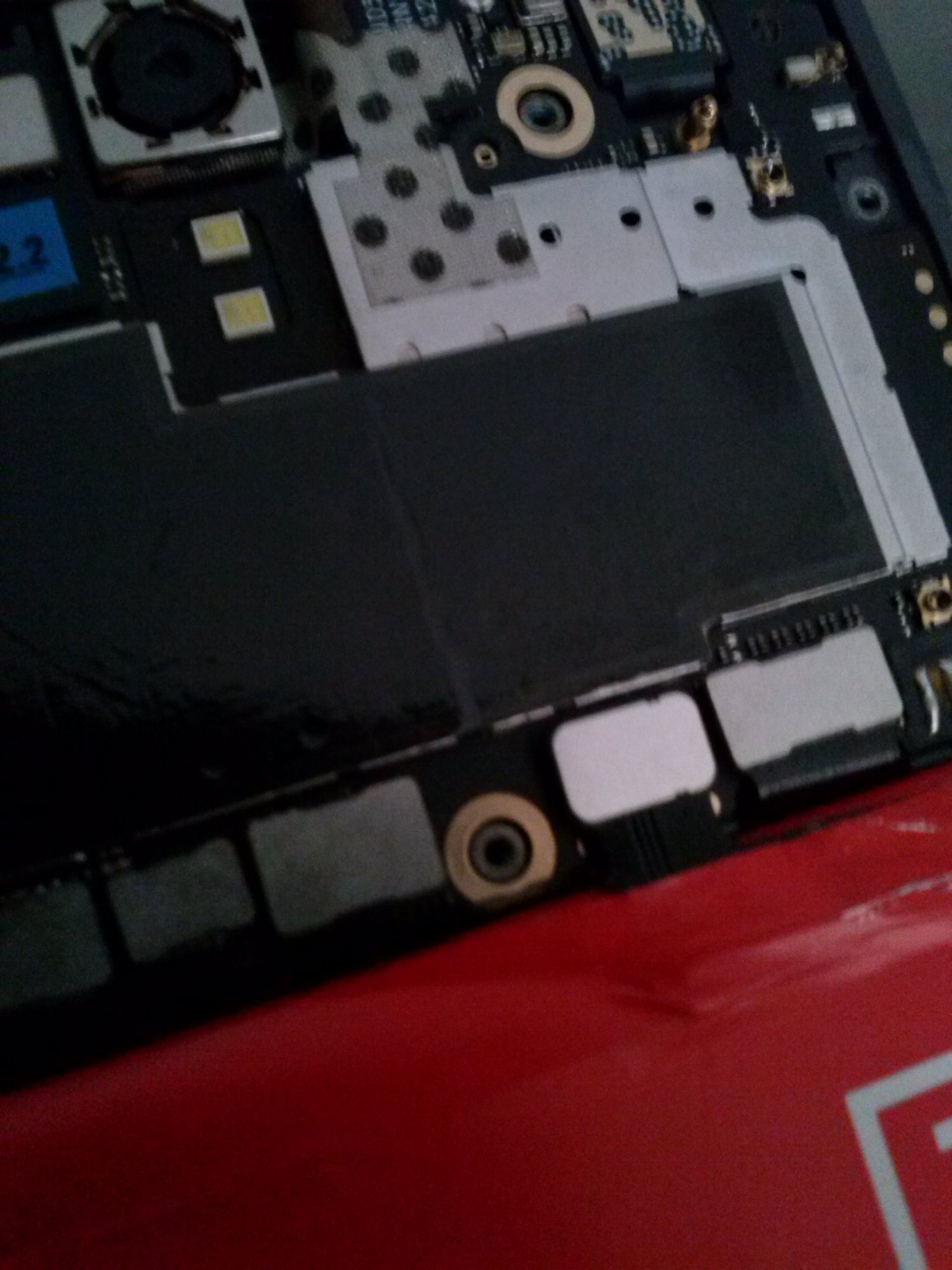

I replaced my OPO's battery, and now it shows the "battery too low charge before power on !" screen, after a couple of minutes it goes away just to show the charging icon stuck at 00%.
It may sometimes boot while plugged in, but won't charge, and turns off immediately after being disconnected.
I can also access cyanogenmod recovery.

Here are some images to help state my problem:
00% and no more

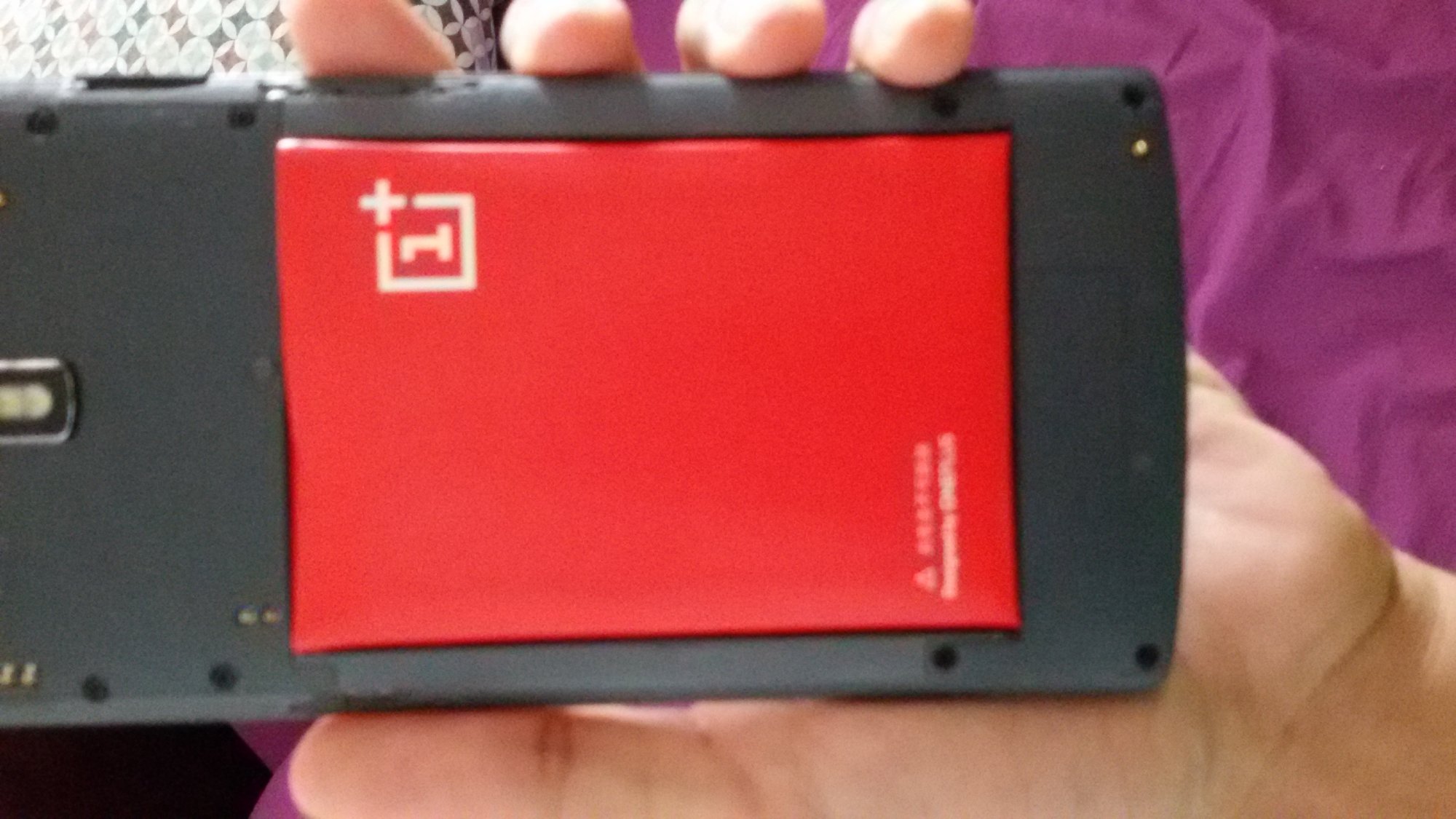

If you post a picture of the battery front and back Juan these guys may be able to tell you if it's it's a knock off or not, it's pretty easy to tell a fake when you've seen a lot of them!!
Looking at the top of the battery the way the "seal" is placed around the top in that second shot, it doesn't look too good to me, but Mike is actually in China, if anyone knows it's him! Good luck!
The covering looks a bit crappy at the top, not applied very well, but I've not seen a OnePlus battery myself in person.
Here's a OnePlus, looks like it's very much the same, that's not very tidy at the top either. It's only a paper or thin sticky-back plastic covering.

Talk about NOT being conclusive Mike, I felt that lousy "wrapping" job at the top of the battery would be the case cracker for sure, but the original battery looks just as crappy, lmao!!

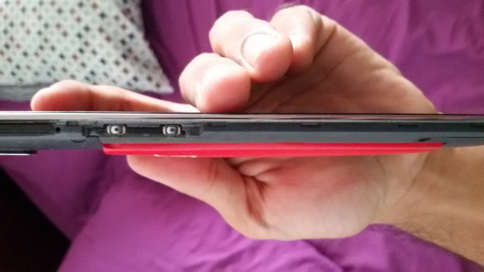

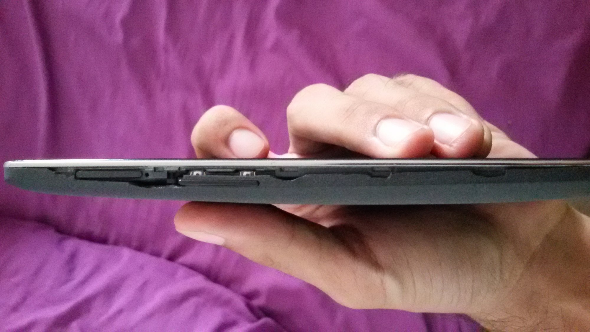

The problem with the original battery is that it got inflated and broke through my phone's backplate, it seemed dangerous, so I disposed it immediately. But then again, the phone booted and charged even with the damaged battery.
The battery wrap got a little bit dull in the top as I had to pull resistor a little in order to connect it.
Attached are the pictures I took before removing the old battery
For reference this is my spare Oppo Find 7 battery. The Oppo F7 and OnePlus One are very closely related phones, and they're made in Oppo's factory. But the appearance is quite different, doesn't have the cheap paper wrapping on it, and it looks just like many other phone batteries. The numbers are very similar, Oppo is BLP659, OnePlus is BLP571. They both maybe interchangeable, I've not seen any information on that. Perhaps they put them in the garish red branded paper wrapper, just to differentiate theirs from an ordinary looking boring Oppo F7 battery? :D
View attachment 88189 View attachment 88191 View attachment 88192
It was dangerous, metal fires are extremely dangerous, which could have happened. The battery could have been faulty, OR there was a fault in the charging circuit and it overcharged or overvoltaged it. Given what's happening with the replacement not charging, but the phone is powering up when on the charger. That makes me think there could be a fusible safety component in the phone's charging circuit, and it's now blown. Which means the phone will require OnePlus service.

The battery you posted looks like an official one plus battery to me.. They aren't wrapped in plastic like a lot of batteries.. I watched and interview one time and it said they did this BC they wanted the battery to be thinner! Not sure how true it is but yes that battery looks official to me..
