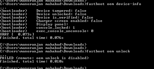

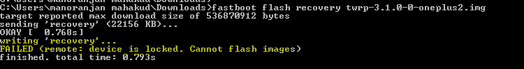

i
Its connected to the PC , and detected too .
But when i try to do flash recovery it say its locked
Then i try to unlock but no luck .Please review the screen shot
If you can't unlock the bootloader I don't know.
After reading some wiping data/cache in recovery is equivalent of factory reset.
