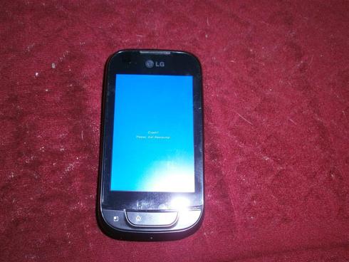

So.. i bought this Lg Optimus net like 5 days back...everything worked fine till
i updated Google maps on it and i started getting a blue screen with "collecting memory dump"... well i restarted by phone and removed the update.. and later today, i got a blue screen again when i was browsing with default browser.... well this is getting me worried.. any suggestions..
are there any tools to scan the memory for android phone..
well this is my first android phone... still trying to get used to it :P
Regards,
Nik
akashash5 is right. Try hard resetting. To hard reset, turn off your phone. When It turned off completly, press an hold:
Volume Up Button (on top-left side) + Home button + Power button. You'll see LG logo but don't release buttons. Then you'll see an Android logo is coming out of a white box.
When you see this, release buttons.
Phone will perform hard reset.
