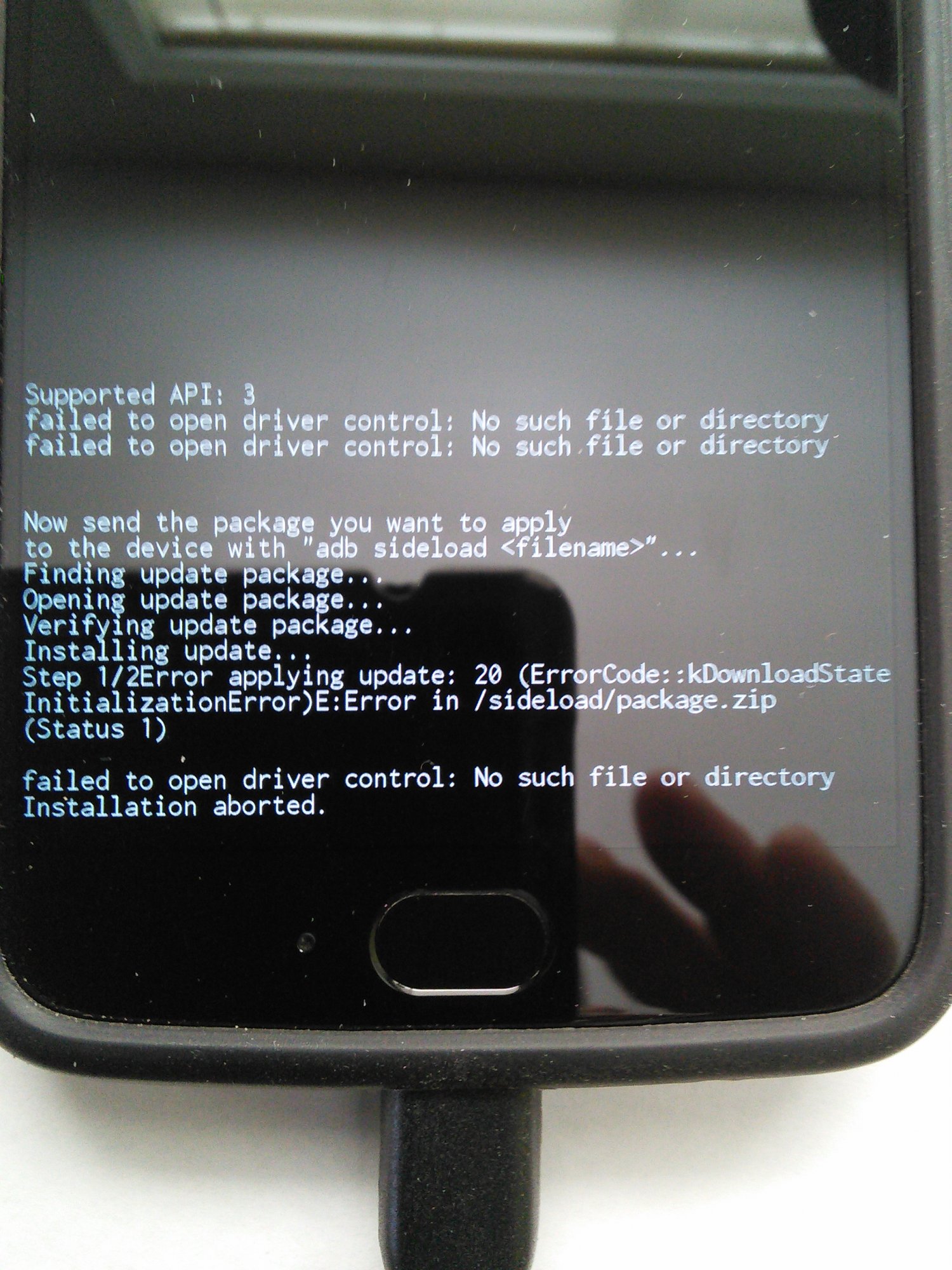

Got tired of waiting and decided to try adb sideload. Seems to be working. At 77% and counting. Probably do the Jan and Feb updates also.
Well, that sucks.
All attempts at adb sideload failed. Found the full Oreo firmware and did a manual flash. Wanted to go ahead and unlock the bootloader anyway.
Wouldn't you know it, got prompted for Jan security update as I was setting it up. Motorola kills me!
Finished installing Jan security update, checked for system updates, now downloading Feb security update.
Must have been a glitch in my stock 7.1.1 that prevented me receiving any OTA updates and manual flash of 8.0 fixed it.
