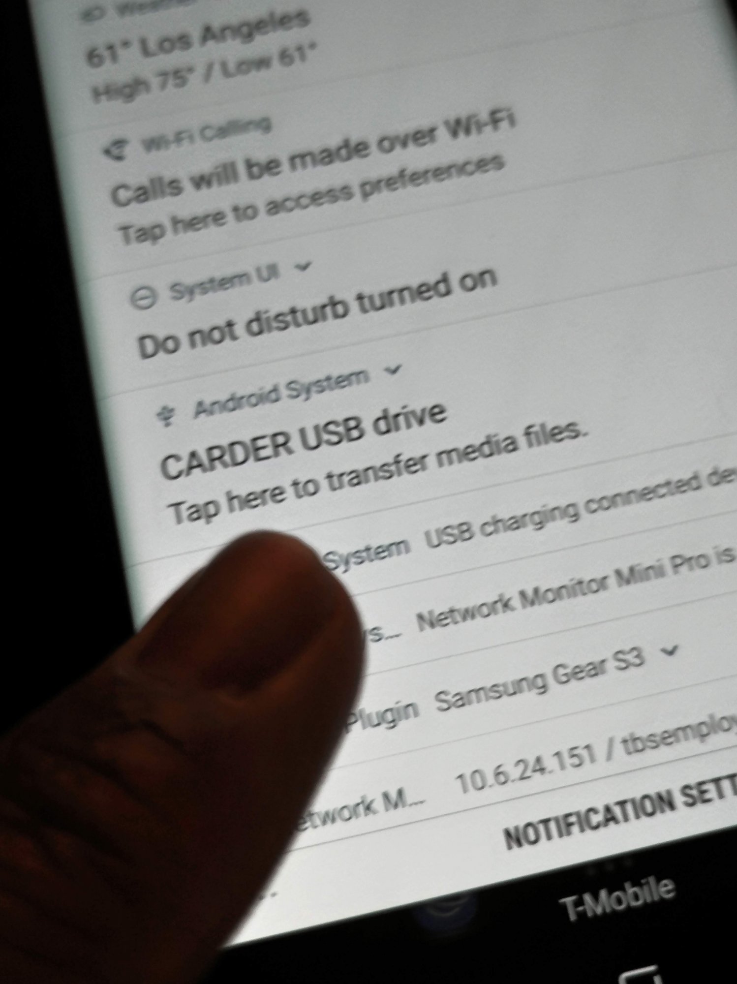

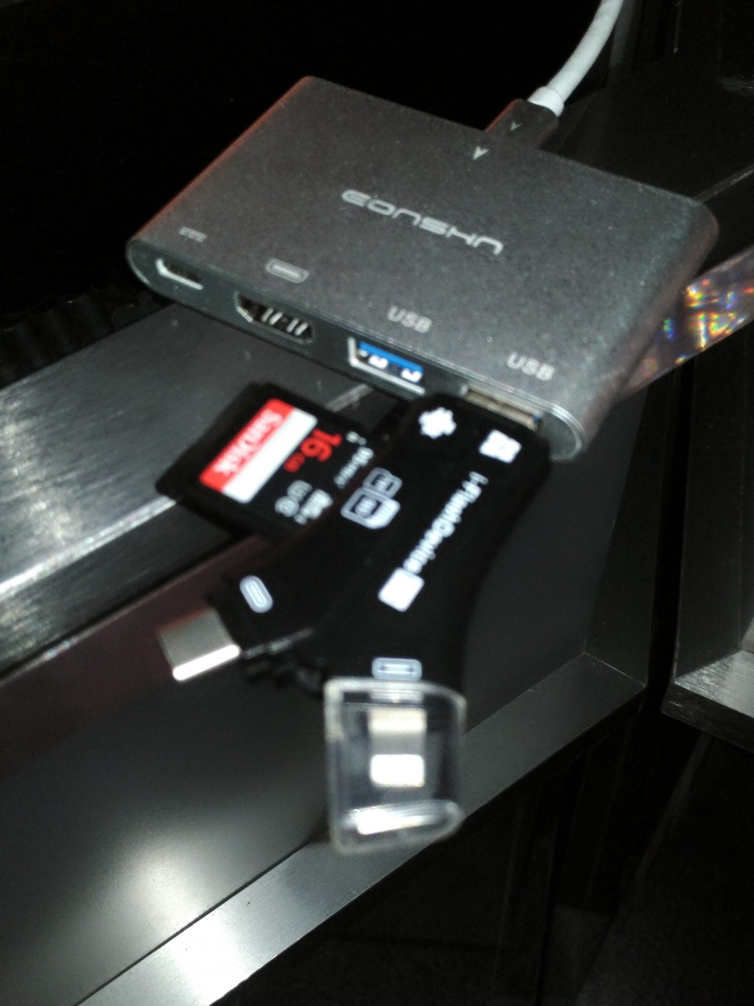

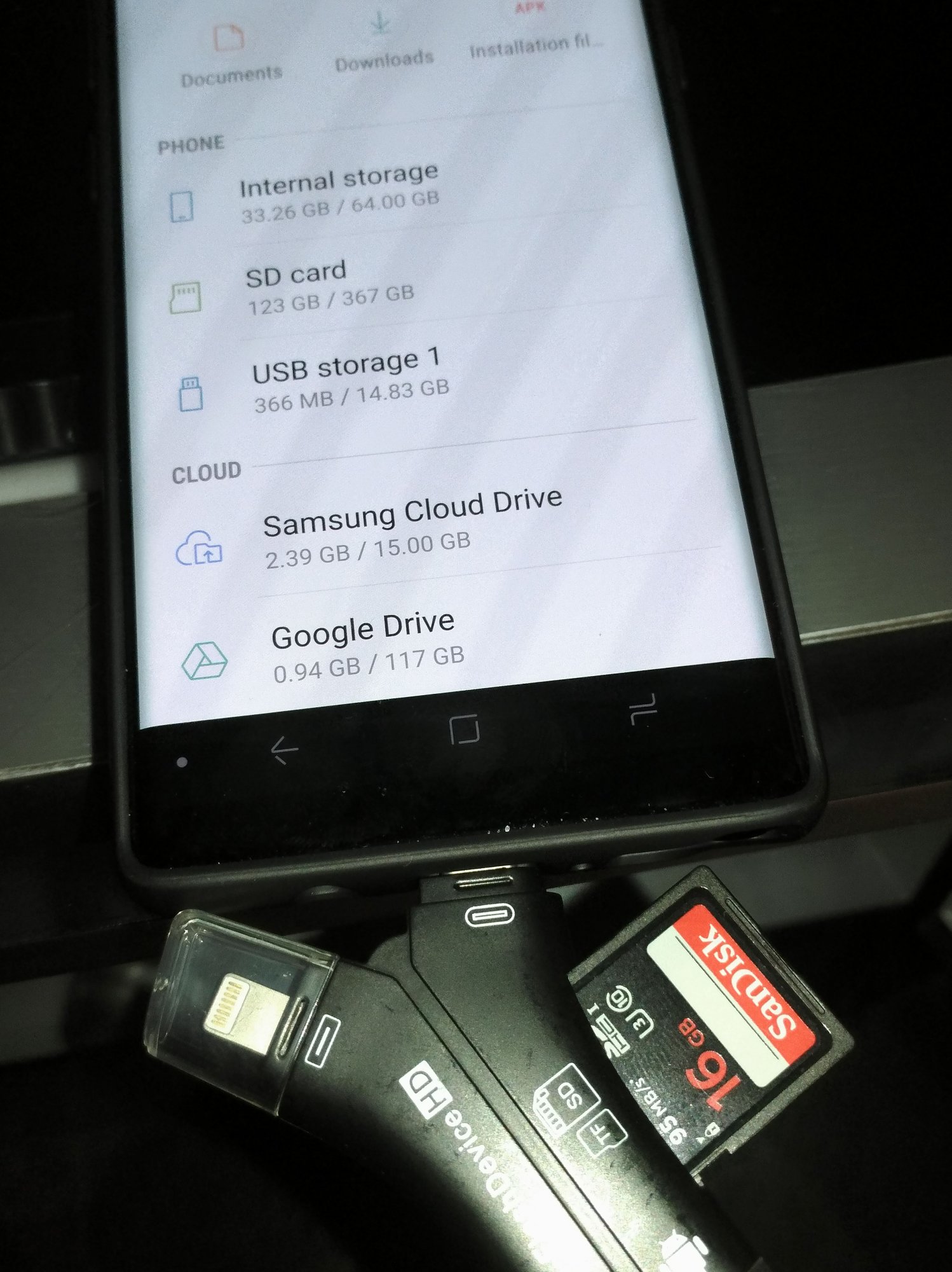

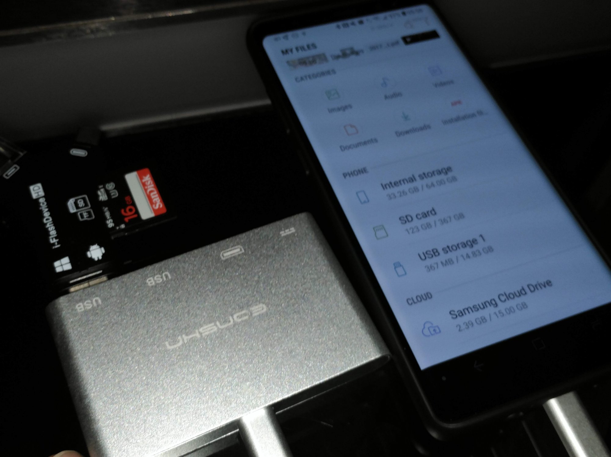

I have two OTG devices that work flawlessly with the note 8. See photos. The SD card is a 16gig and its the last USB device in the files app on the phone. I’m using the stock FILES app on thr note 8.
I used the two OTG devices together in the last photo to show they can both work together and that fact that i did not have a usb thumb drive to use on the usb type B OTG device. :p
