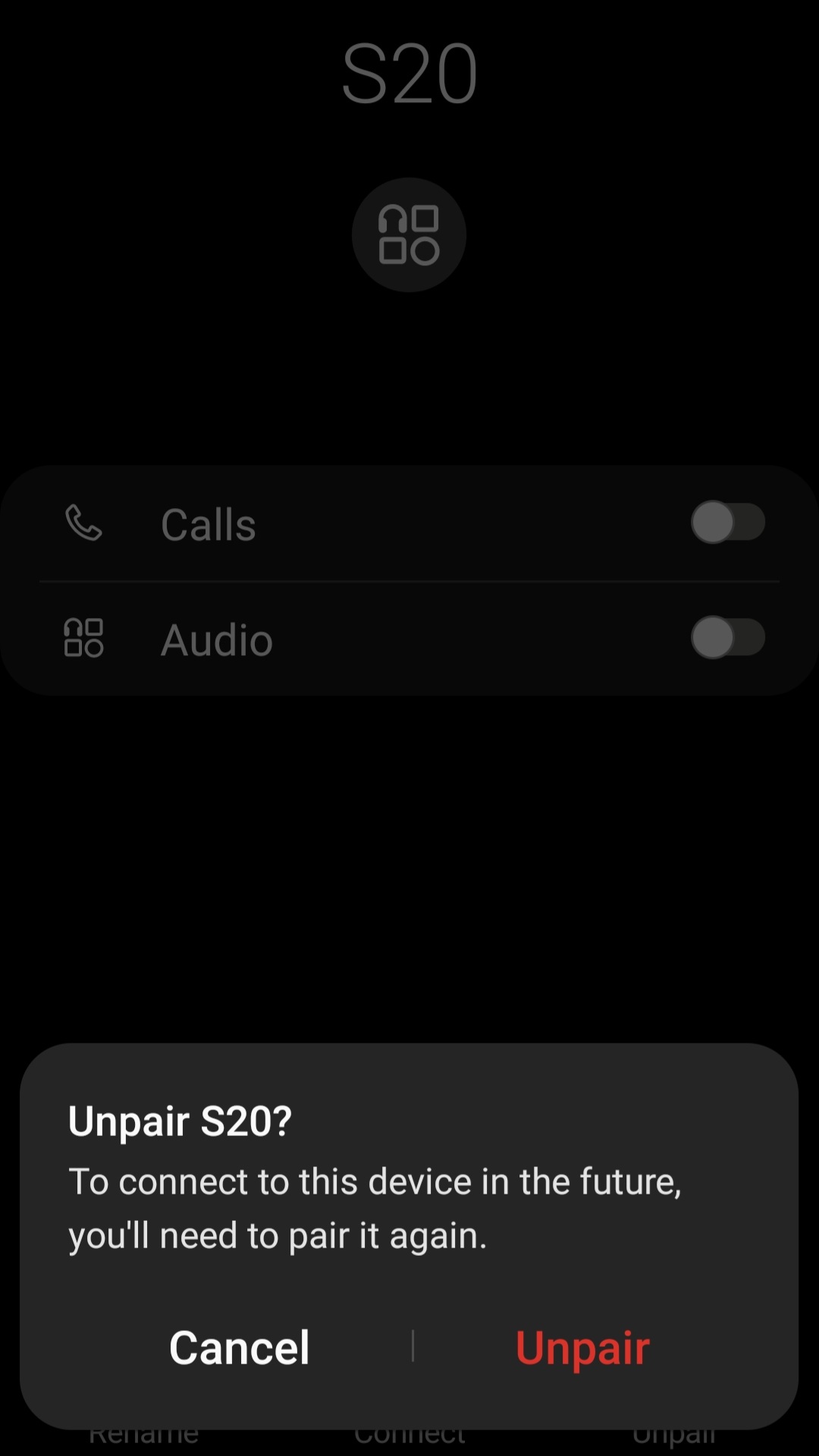

I don't know what phone or tablet you've got there, but in Settings > Bluetooth, it should have a list of all the BT devices that its paired with and can automatically connect to, along with an option to unpair. e.g. this "Buick Intellilink". Once that BT device is unpaired, the only way it can connect again, is to manually go into pairing mode for it
This is from my Samsung Note20, but other devices will have something similar.
Unfortunately that's not the case in this scenario, based on my statements of "BT automatically pairs when the phone is directly connected." and "...when the phone isn't plugged in to Intellilink, which overrides the external connection."
So I need something that would block the phone from even allowing intellilink to establish the link.
