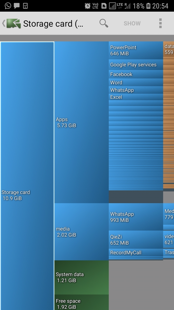

Hi,
Even I am facing the same problem Samsung J7 NXT cimes with 16 Gb internal memory
I have less apps.
Apps - 1.7GB
Videos - 1GB
Audio - 11.5Mb
Yet it shows 14 GB OUT OF 16GB used.
I downloaded Disk usage app.
On left it shows total as 10GB only. Then it means my phone is 10GB only while Samsung claimed it 16GB.??
Pls guide me
The other 5 GB has been reserved for system partitions. Because you are not rooted you cannot see the content of those partitions, so DiskUsage is only showing you the user-accessible part of the storage.
(I say "the other 5GB" because that is showing 10.9 GB rather than 10).
