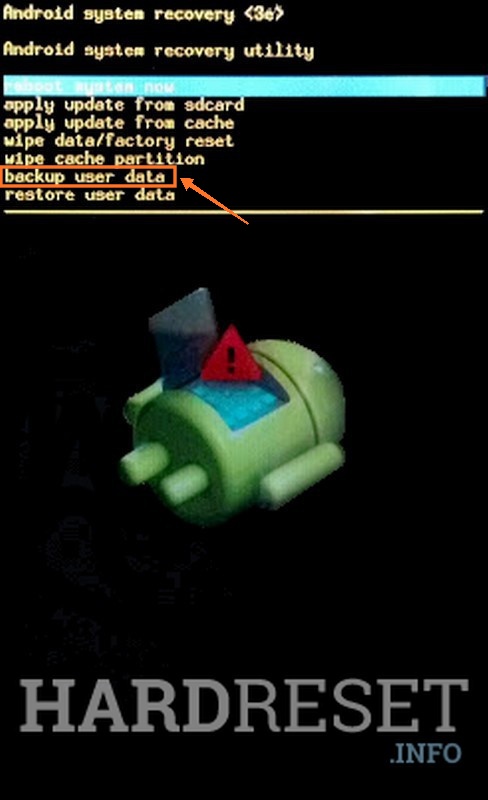

Well in my experience "back up user data" isn't usually a option of the stock recovery, so I'm not certain what else is different about this phone.
According to a quick web search that phone has a user-removable battery, so you could try removing the battery for a few minutes (to ensure that the semiconductor is fully discharged) then try again. There's a chance that it's some corrupt data in RAM or something like that.
Otherwise I really don't know: interrupting a firmware flash can cause real trouble, but interrupting a data backup logically shouldn't do anything more than mess up that backup. If you can find the stock firmware for that phone you might be able to reflash it (that's what fastboot mode is for). If you can install fastboot on a computer you might be able to use it to clear the system cache partition, but it would be a bit weird if that were blocking recovery mode.

Thanks a lot Hadron, well your right after checking what normal Android options look like, it would appear Laude S800 has its own flavour of stock firmware ... Just for reference I found the exact Android recovery boot screen that I got when I tried recovery, please see attached image

Thanks for the reply! After leaving the battery out for a while and putting it back again and connecting to my PC,.I was able to see the logo of Laude, which is a plus! Now will try to flash a rom on it again! Thanks for the link for ROM, will give it a try ... Any good links or tutorials on how to flash the ROM as I've never done it before?
