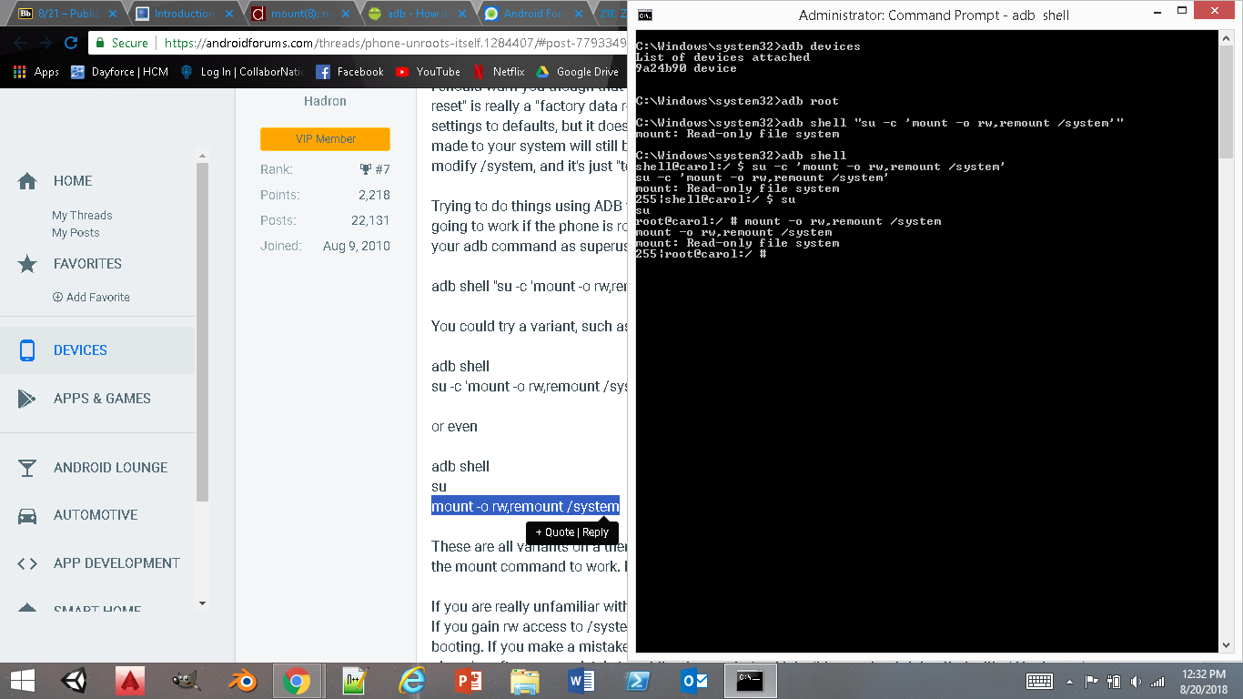

I have a ZTE Quartz z797c jelly bean 4.3. I used the app "KingRoot" (not KingoRoot) to root my phone and checked it with a root checker app. I've been able to access su from terminal and backup my device with Titanium backup. But somehow, my phone unroots itself and I am not able to grant su privileges to any app. So I went back to the root checker and it said that I was unrooted. I went back to the KingRoot app and it still said I was rooted. After that I tried terminal. Couldn't access su. To get root back, I reboot my phone so KingRoot will notice that it's unrooted. Then I root it again. But like 20 minutes later my phone will unroot itself again. So, whatever it is i want to do, I have about a 20 minute window before I have to reboot and reroot to continue. Can you guys help? Also, I've tried switching the SU Binary from KingRoot to SuperSU but it fails everytime. I've also downloaded a shell script from youtube that removes KingRoot and replaces it with SuperSU, but when I try to "update the binary" it always says "installation failed." That was one of my troubleshooting attempts, trying to see if it was the KingRoot app itself or if it was just my phone. Also, i researched my phone and everywhere on the internet says my phone can't be rooted... but i did... kind of... In another one of my attempts to fix this, I went to terminal and tried mounting /system as rw. It returned "mount: read only file system." I tried it again using my laptop. These are the commands.
adb devices --> (mine was listed, forgot the name)
adb root --> (no issues after rooting with KingRoot)
adb shell --> (went to shell)
mount -o rw,remount /system --> "mount: read only file system"
So, it failed again. In my next attempt, I tried linking /system/bin with a /data/data/ folder (rw) so I could try to add a /system/bin/su folder, but it said that the path was read only. So, I'm unsure of what to do next. Even if you don't have an answer, I'll accept any troubleshooting suggestions. Now, I don't much about androids or linux commands (everything i've done so far has been either youtube or commands from xda forums) so you will probably have to explain each step in detail (an explanation of each step is nice so i know why to do it and what it's doing. I don't like following steps blindly, but its what ive done so far.)

Trying to do things using ADB that require root access, such as mounting /system rw (read/write), is of course only going to work if the phone is rooted. If you think the "adb root"/Kingroot thing has worked, then you could try to run your adb command as superuser, e.g.
adb shell "su -c 'mount -o rw,remount /system'"
You could try a variant, such as:
adb shell
or even
adb shell
su
These are all variants on a theme: "su" is a command to raise your privileges to superuser level, which is needed for the mount command to work. If the phone isn't rooted the su command won't be accepted.
If you are really unfamiliar with adb, android and linux shell commands I'd be very careful trying to do things this way. If you gain rw access to /system you have the ability to remove or overwrite things that will prevent the phone from booting. If you make a mistake like that, and have no custom recovery, you'll need to have a way of reflashing the phone's software completely to get it going again (and I don't know about doing that with ZTE phones).
Thank you for your input! These are the results

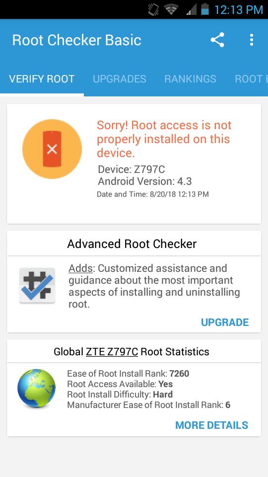

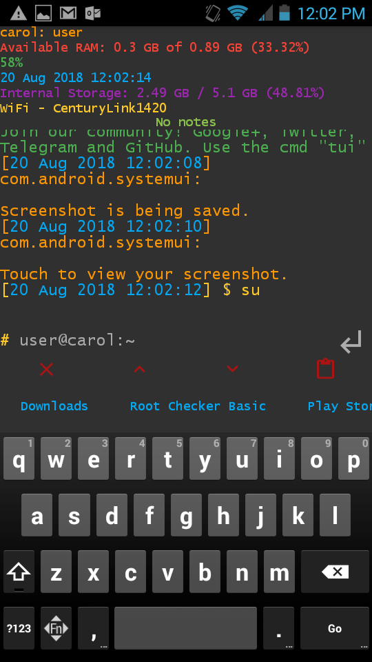

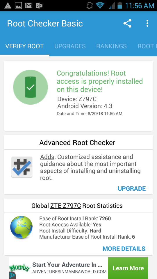

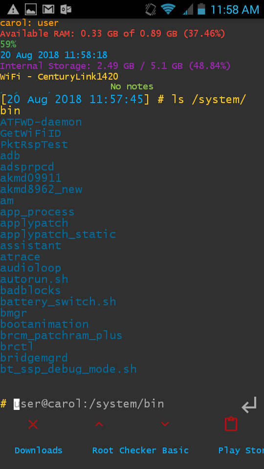

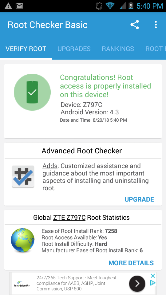

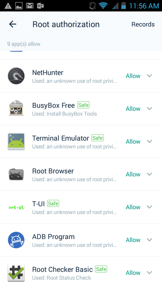

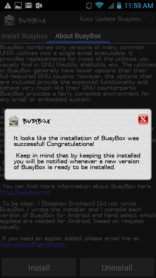

Here is proof that my phone was rooted:

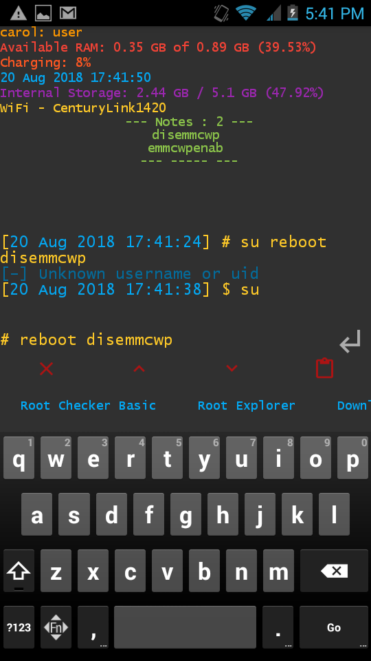

OK, You need to disable Write protection (change RO to RW).. Immediately after Rooting, open a terminal and enter:
su
reboot disemmcwp
After phone reboots, try to Root again. This is a common issue with Rooting ZTE devices and what I suggested above is our normal workaround for that, thanks to @hroark13 for finding it .. Hope it helps

Ok thanks man, and if I create a /system/bin/su directory (because my phone doesn't have one) and run these commands, will supersu stay on my phone as the main su binary?
adb push su /system/bin/su
adb shell chmod 6755 /system/bin/su
adb shell chown root:root /system/bin/su

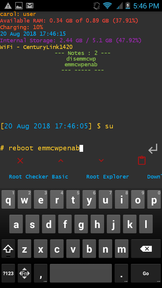

Results from your earlier suggestion:
Image #1 Not rooted
Image #2 Rooted with KingoRoot
Image #3 su reboot disemmcwp
Image #4 Not rooted
Image #5 Rooted again with KingoRoot
Image #6 su reboot emmcwpenab
Image #7 Not rooted
Conclusion: rooting after disabling emmc write protection failed

Uhh.. Don't do reboot emmcwpenab cmd unless you intentionally want to enable write protection, which will prevent any Rooting. Try again and only do the cmd I gave ya the 1st time, then try Root app again
