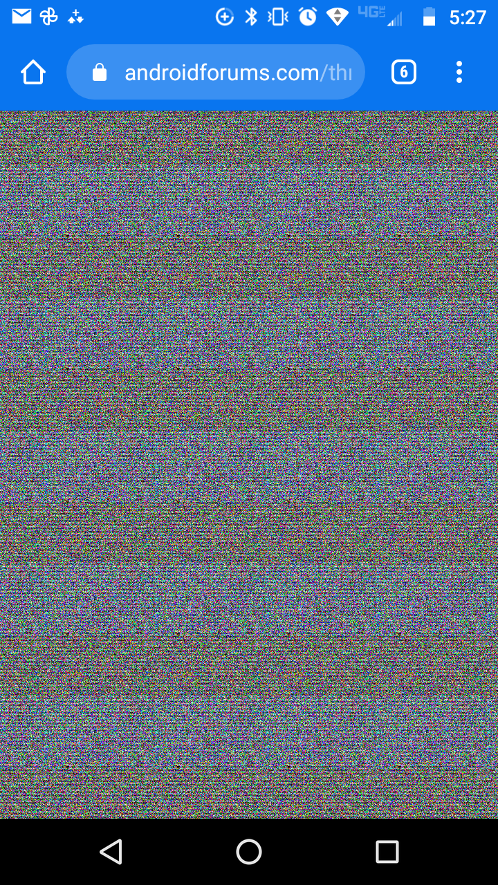

Phone will NOT charge at all, sleeping issues
It's gotten to the point where I have to carefully bend the end of the sideways and place my phone upside down in a cup for it, and jam the end into my phone just so it can hold in place. And even then most the time it just shows the ⚠️ symbol.

Oooh goodness.. that looks like "the poptart screen" (of dying/death). Ok, so here's what I think may be a potential issue:
  • Bad USB cable
  • Bad USB port
  • Bad ribbon wire (connects the display to the motherboard)
The 1st one, you can replace. The last 2, you'll need a new device (unfortunately). As for sleep issues, the biggest ones were caused by Facebook, Carrier specific apps, Amazon, etc.. apps that you've never opened will also keep the device awake in hopes that you'll mess with it more or open the one draining the battery. My solution is kinda harsh to most ppl but basically I just disable them in Settings/apps if I never used them to begin with or open them and them them Spam you with their relentless ads so you can finally tell the apps No or whatever ya need.
I have had the same charging problems on a few phones. As bcrichster mentioned. A new USB cable can help. Although eventually the socket in my phones always die. New cable is short term bandaind aid on older phone. I'm actually on this forum today trying to get help recovering photos from my last phone. I'm and electrical engineer with 20+ years experience soldering motherboards etc, even I cant reliably change the USB port on a phone. Its a very tricky job and if I was charging hourly rate often cost more than new phone. While only offering 50% chance of not destroying phone during repair. I have sometimes been able to remove the battery and add a holder for 18650 battery's which can be removed to charge, but this is not pocket friendly and can confuse phones that monitor batterys closely, as the temperature sensor needs to be bypassed or tricked with a fake reading.There may be others with better experience that can deal with this kind of problem more successfully, but that's my experience.

I had my 1 year old Nokia repaired under warranty (very efficiently) because of the fiddling to hold the cable at an exact position.
I had learned through Nokia forums it was a known issue with the charging port on mine and one or two other models where the port internally warped / expanded or loosened due to poor material etc.
As soon as I mentioned to Nokia Chat support it seemed a known issue there were no more questions and they were terrific.
This was also my first usb-c phone and I wasn't pleased, and never understood the need to replace the shape because some found putting the cable in one way was too much pfaff.
I saw 2 videos where both the port and a charging board were replaced, but I didn't need to resort to that.
It sounds like your port expanded or warped in some way.
When I was having the issue I could bring up the full screen battery icon in Settings - Battery and if it turned Blue and said Charging it was charging in that position. If the home screen showed it was charging but the battery icon was white on the battery screen it wasn't charging, so the home screen / notification bar was lying :mad:

It does sound like a motherboard problem as the previous posters said, but maybe something is still repairable or salvageable.
