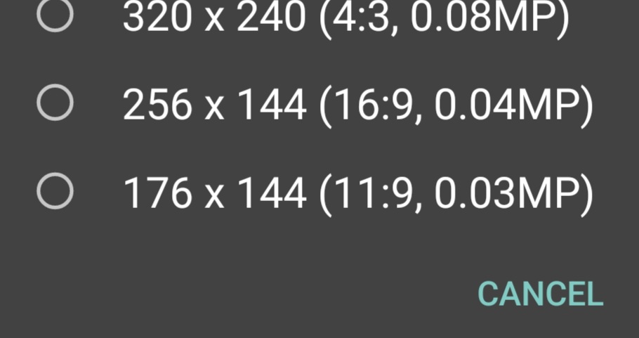

the "open camera" open source app uses the camera2 api for listing the avaliable photo resolutions, on older devices such as S8,S9 users had low resolutions such as 176x144 bit on the s20 and s22 that resolution isn't available.
if anyone could add that resolution to the newer devices would help everyone so much.

photo resolution of 176x144 has been removed either by open camera or by camera2 api so the "open camera" app gets the avaliable photo resolutions from camera2 api, how can i add that resolution back to camera2 api

i agree with but here's the thing, on other apps such as "Fast burst camera" the resolution of 176x144 shows up on list but the "fast burst camera" app doesnt provide options such as timestamp or hdr

in "fast burst camera" the resolution of 176x144 works but the app doesn't support timestamp so i tried adding the resolution of 176x144 by manually editing the source code of "open camera" and what happened was is that photos were being taken in 176x144 but the images were distorted.
it would be highly appreciated if an expert showed us how to:
1) successfully add the resolution of 176x144 to the source code of "open camera"
or
2) instruct us on how to add the resolution of 176x144 to camera2 api if root access is granted on the device

yes i did precisely that, i added the resolution of 176x144 to the photo resolutions in the source code in the following java classes in "open camera" source code :
CameraController2.java
ImageSaver.java
the images come out in 176x144 resolution but they are distorted, what am i missing here?
