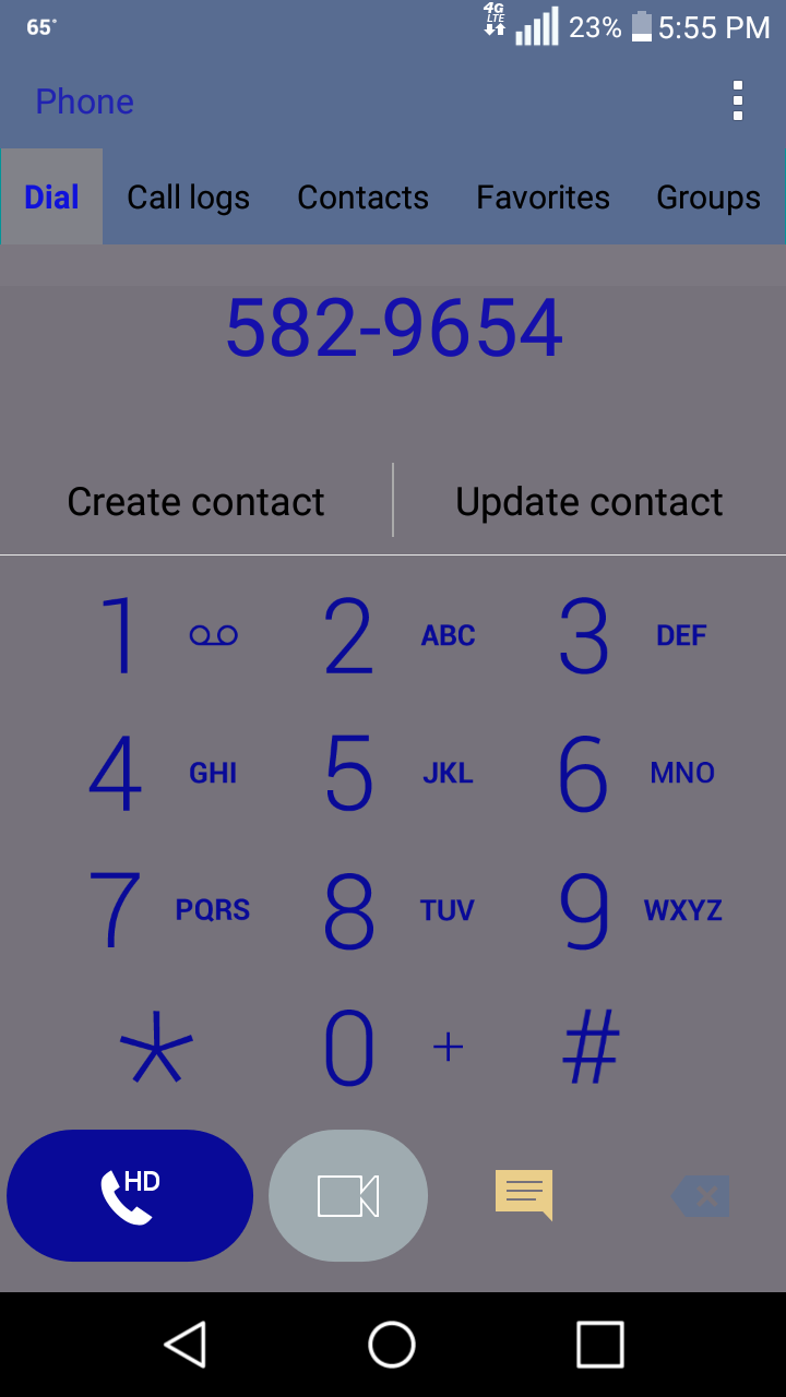

Rooted again using ADB method, TWRP installed, Xposed with LGmod and Layers Manager. I have managed to mod the phone almost completely (with exception of a couple LG apps like Music, Gallery, and DownloadsUI). Using combination of layer apps and xposed LG mod, plus Nova Launcher Pro. You will spend a month playing with the different combos of colors, transparencies, and formatting options.
