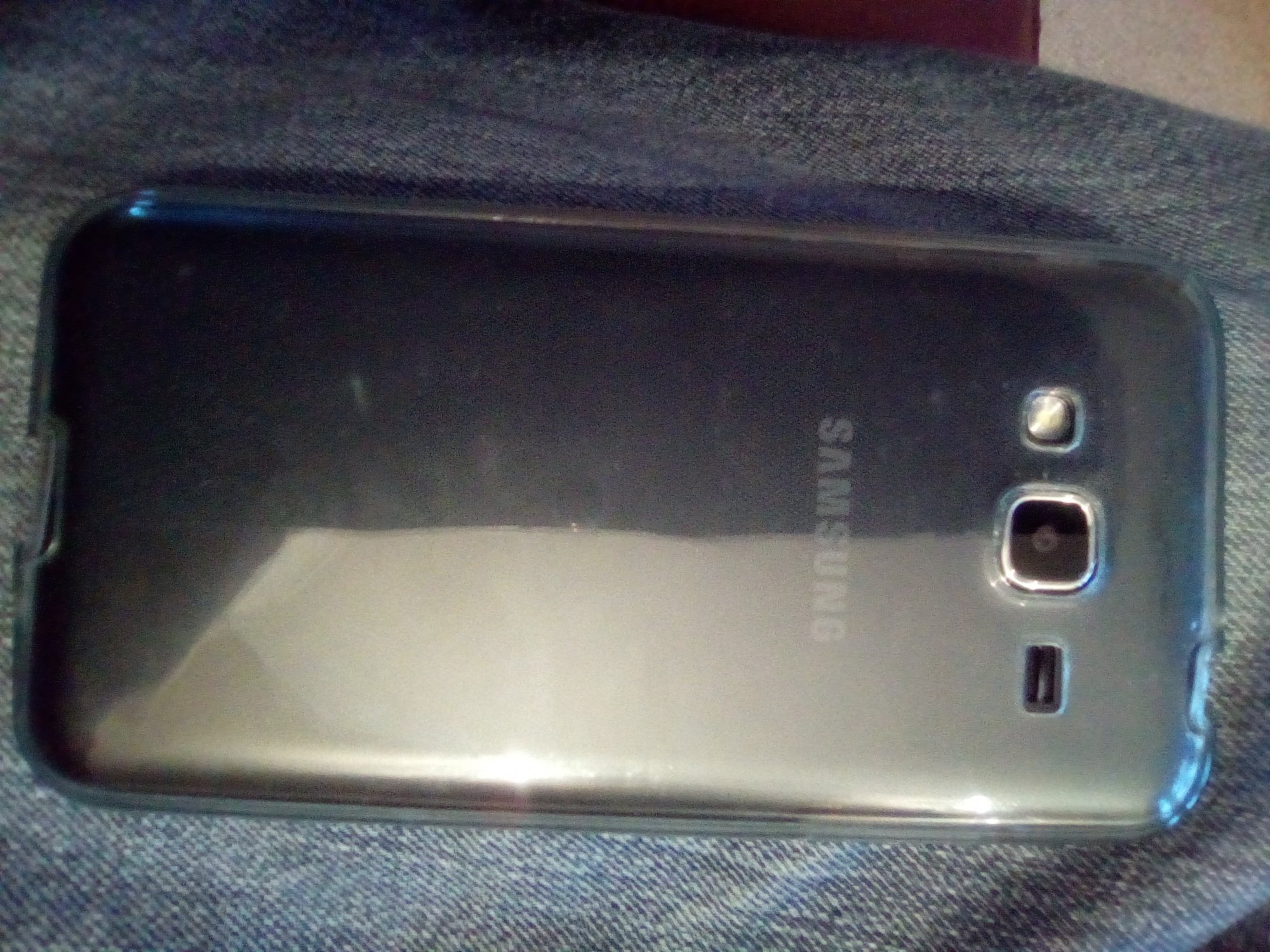

I'm wondering whether to make the hole bigger around the lens and flash (just wondering if the clear cover is having sone kind of an affect on the flash).
Ahh, does the cover not have a hole for the flash? You could be getting some considerable light bleed from the flash. Post a pic if you can.
Here's a pic !
Aah. Well I see what your problem is with the flash. When you enable the LED light is refracted through the clear plastic and glows around the lens causing a heck of a flare and throwing off the adjustment for proper exposure. Try putting a little piece of electrical tape on the inside of the case over the opening for the LED and then cut an X in the tape through the opening and fold the little tabs through the hole. That could effective block the light bleed.
