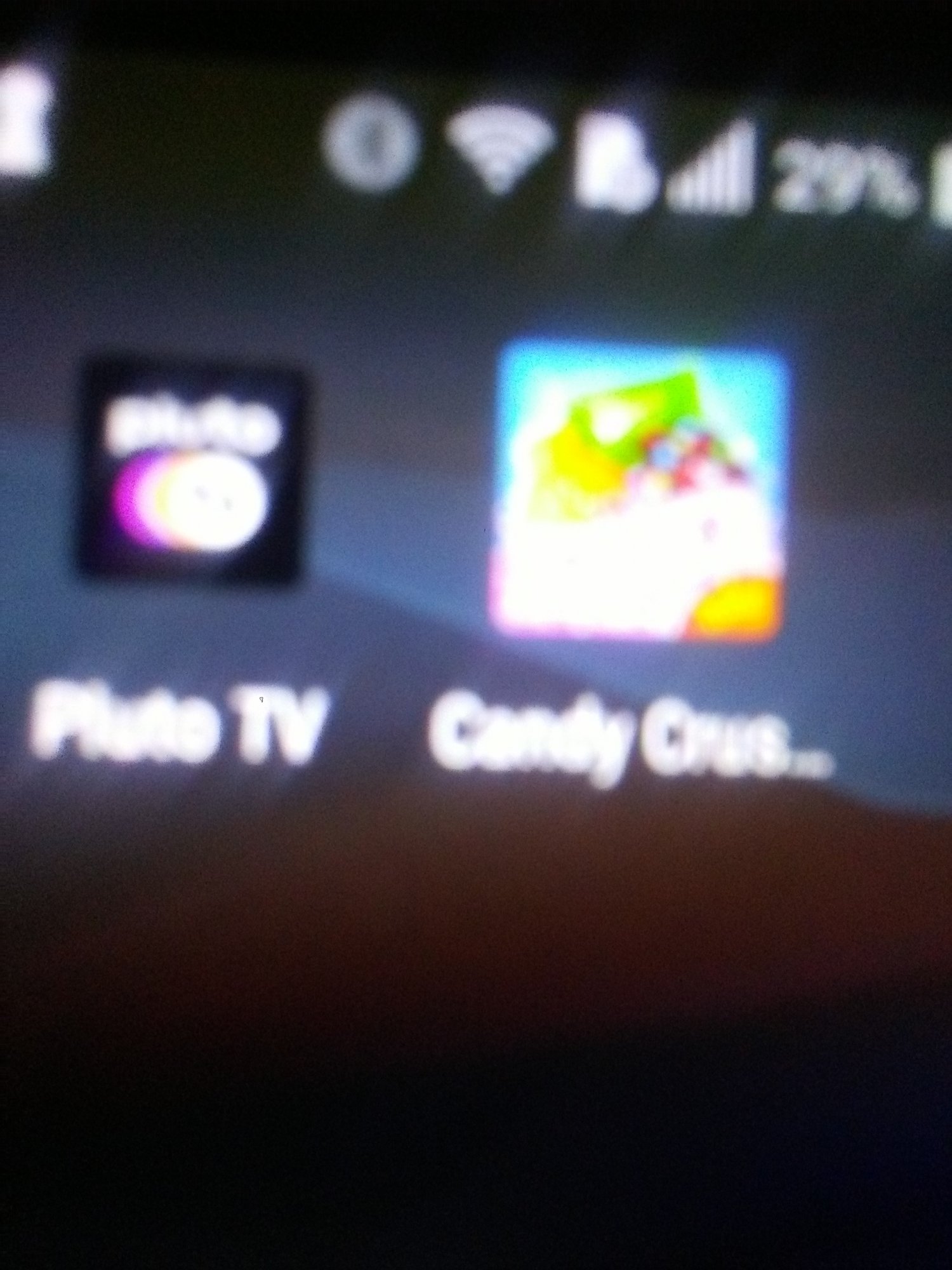

ok here's pictures of the phone with the suspect app installed plus 2 apps just installed by themselves

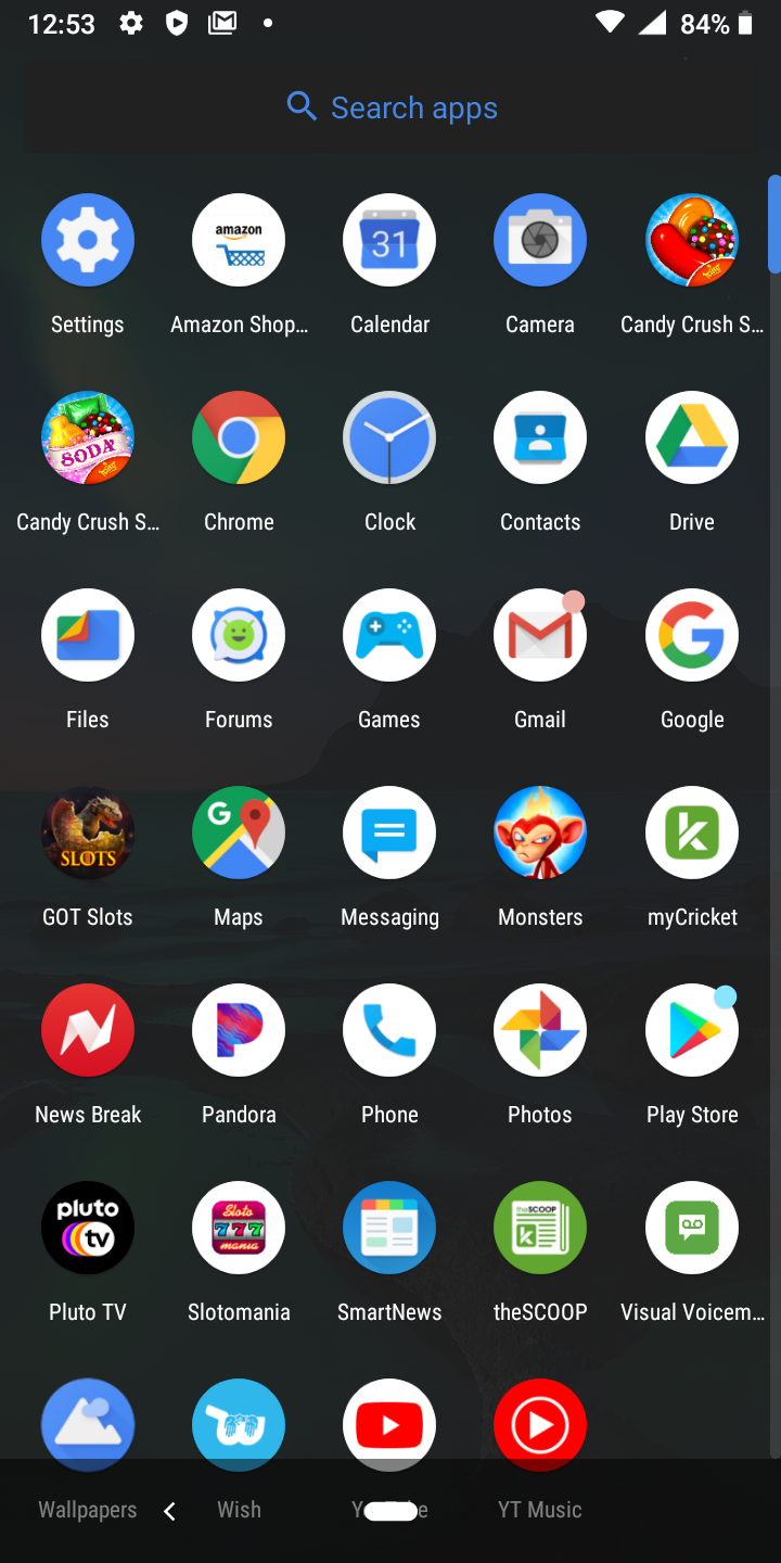

Ok I just did another factory reset and only installed this forums app and did not turn on unknown scources
And it will let me uninstall those game apps, so there not just bloatware are they? Cause I don't remember having.to uninstall them before but I could have just forgot, but also bloatware can't be uninstalled without root, which I do not have
Hang on a sec. What phone is this we are talking about and who's your carrier? The reason I ask is that AT&T used to bundle a lot of non-removable bloatware with their branded devices. A couple of years ago they changed the model to download the bloat from the play store on first run. This did a couple of things ... It saved them on development of custom firmware for all their offered models, it allowed them to change what apps were downloaded quickly and easily, if they wanted to add or remove sponsors. And, it gave end users the ability to completely uninstall the apps if they wanted since they weren't technically part of the System ... just the script to install them was.
I wonder if that's what's going on with your phone?
The easy way to test this is to create a test gmail account with no links to your primary account. Then factory reset your phone and use the test account to login to the play store. If the games show up, then it's most likely sponsored bloat being installed by either your carrier or the manufacturer.

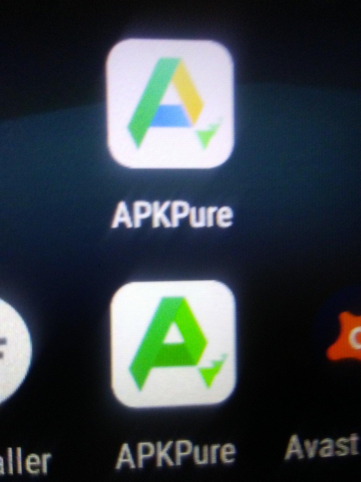

Here is screenshots of my old phone also cricket
The apkpure in the middle is the real app the one on top is the link to apkpure.com and the bottom is apk file manager
Edit : I'm not sure where I got the APK link from that acted like it was being installed but just added a icon on my home screen and after that I started getting apps downloaded, now a possibility is that the APK pure was the 1st app I installed after a reset and my phone was still in the process of installing bloatware, but in my experience all bloatware is already installed by by default and not download after everything is booted up
