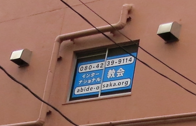

My pastor had an idea that has some merit. Each room has a small exhaust fan on the outside wall, and we never use the fans. They are about 4 meters apart and not too far from where the TV/camera locations are (very close in the preschool case, farther in the church case because the camera is in a different corner of the room). It's third floor, but running a couple cable(s) between them would not be hard, due to a handy window right between them. We can't fasten conduit to the wall, but it looks like we could "drape" flexible PVC pipe over two brackets holding an existing duct, and hook the ends under the fan port hoods with PVC elbow joints, hopefully keeping the weather and sunlight (south-facing wall!) sufficiently off the cables.
b7cYKLd
I don't know what type of cable you might be using, but we have a standard RJ45 ethernet cable that goes from a building to the other one across the small street. The cable served the buildings for almost two years until the other building has its own adsl connection. When I pulled the cable down, it was in very good condition, kind of harder to roll but perfectly functional.

I'm starting to look seriously at the prospect of running cable outside (mentioned before with photo). I've also been advised by others that I should convert the HDMI to SDI and back again - I'm mulling that over. More money because I'd need to buy two camcorders rather than asking my friends for old, unused smartphones, but the signal would be rock-solid.
