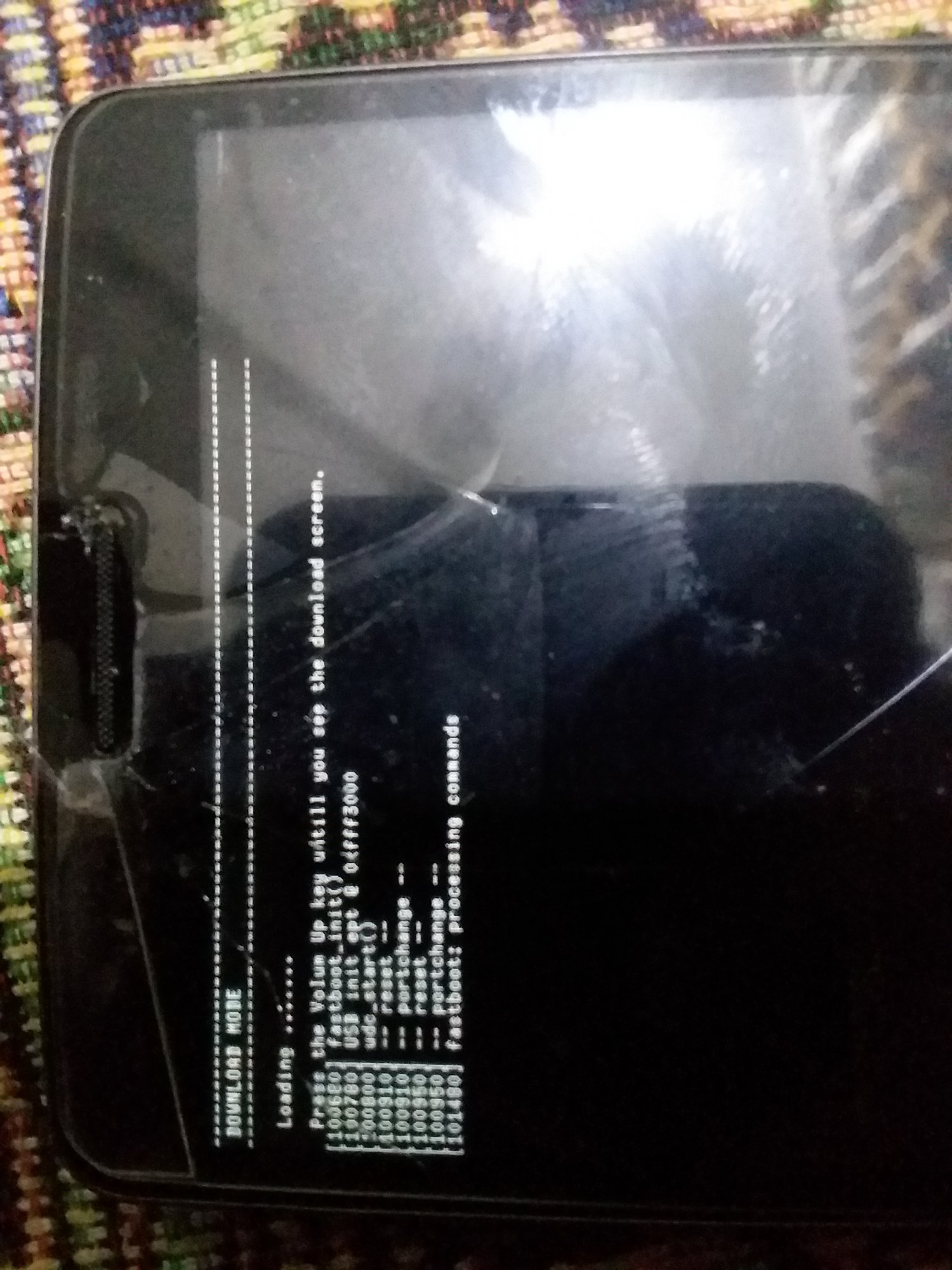

Hello.
I have a problem with my mobile (LG G3 vigor LS885 sprint), You can see to image "Pic_1" which appear this problem when I try to reboot the mobile whereas show some lines about fastboot and I want to alert you about the mobile not show on PC (only show a message about connecting with unknow device) though I installed some drivers LG mobile on PC.

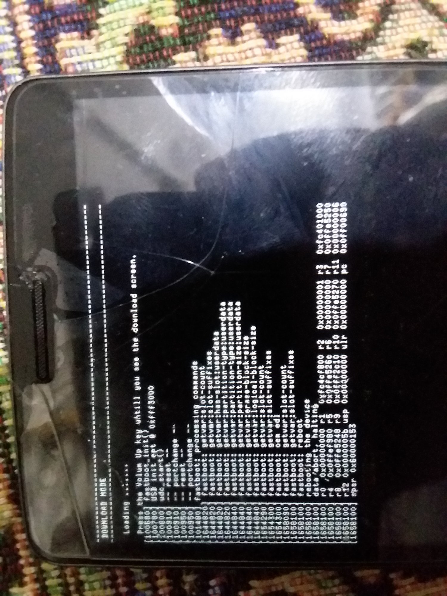

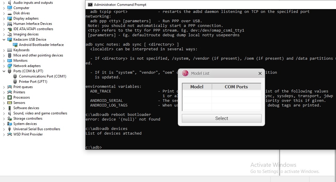

I searched about this problem and I tried to solve it by some solves, such as: make a factory reset for the mobile but show alert about can't format the mobile, then I tried to access to download mode but in it showed same these lines (please see to image: Pic_2), also I tried use LGUP but I can't use it because not access to the port after connected mobile with PC, also I used ADB but here also mobile not show after wrote a command: adb devices, and if I want to reboot mobile in this state then this process not completed (please see to image: Pic_3), and also I changed the mobile battery.

The screen is cracked, did the problem start when you dropped it. Anyway, the' Data, Abort Halting' and a register dump looks like phone is badly corrupted. to get a register dump like that I'd think that the Linux kernel that Android runs on has become corrupt. As you can get into fastboot and use ADB, you may be able to reflash with the original firmware from LG.

I'm using windows 7 (Not 10) and if I connecting the mobile with PC then I will see in devices manager unknown device but after some seconds, it will hidden from devices manager even though the mobile is stilling connect with the PC.

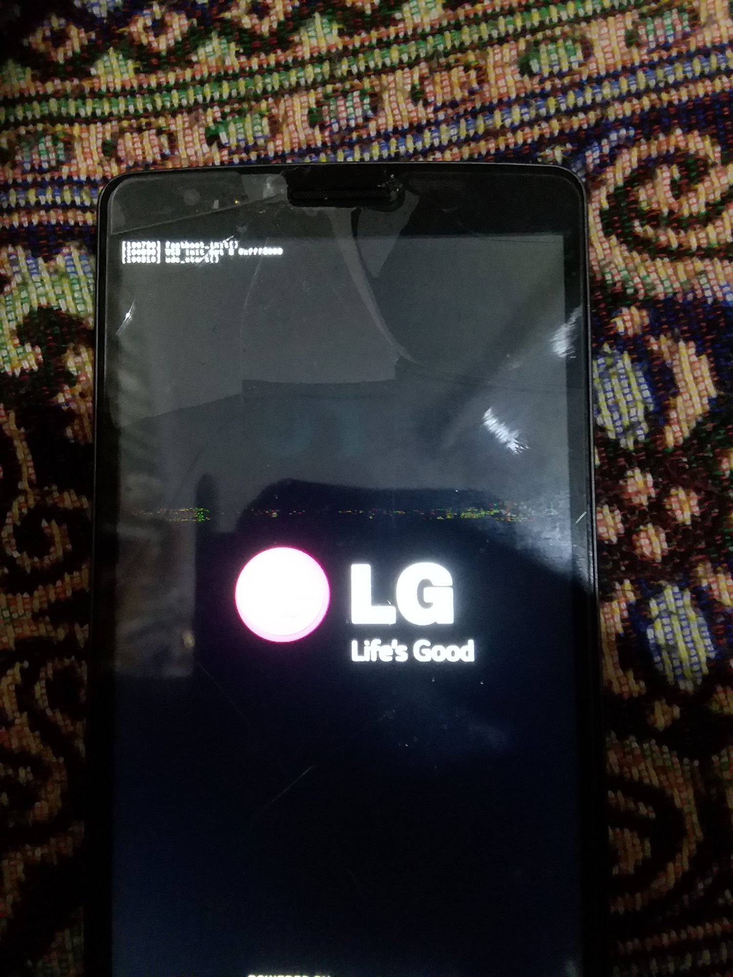

Hello,
I tried to connect mobile with PC include Win10 but repeat the same thing (no port and no device) and I didn't found "MTP USB Device".
Please see to attach image.
