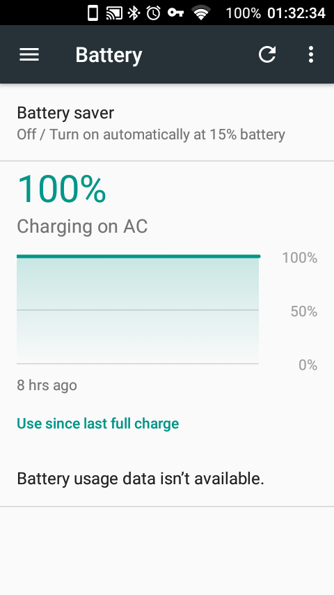

Here is a screenshot of my Battery page, when I am using a 1.5A charger with a flat 10' long cord.
If I was using a bad cord, or if I was plugged into a computer's USB jack for charging, it would say 'USB' instead of 'AC'.
