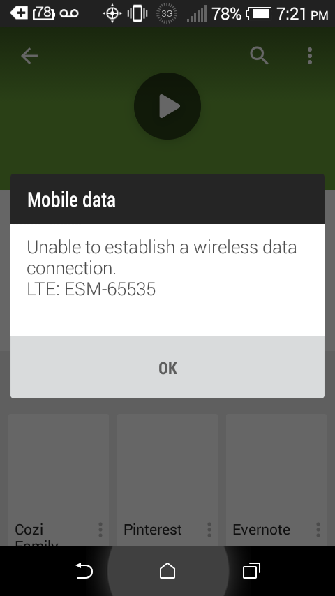

I just think it's too coincidental that I never have problems with LTE service until now and it's conveniently attributed to an outage so that the CSR doesn't have to do anything except give me a cookie cutter explanation. That and the fact that it's persisted for several weeks make me skeptical. The only thing that gives the outage theory any credence is that my other Virgin phone (HTC Desire 510), which isn't activated, only shows the 3G symbol as well. I also got an LTE error message on the HTC device today; I'm not sure what it means as far as the outage theory goes. All else fails, I may switch to the HTC phone for a day or two to see how it works.
Also, I get an error message when I try to program the Galaxy S3 with the ##72786# dailer code: "Unable to establish wireless data connection LTE: ESM - x EMM - 8" I googled it and many Sprint users of Galaxy S series phone report seeing this message within the last year; it looks like it may be a software issue as some of you have suspected. I tried to get some information from Samsung as to what this message means but alas the CSR was useless.

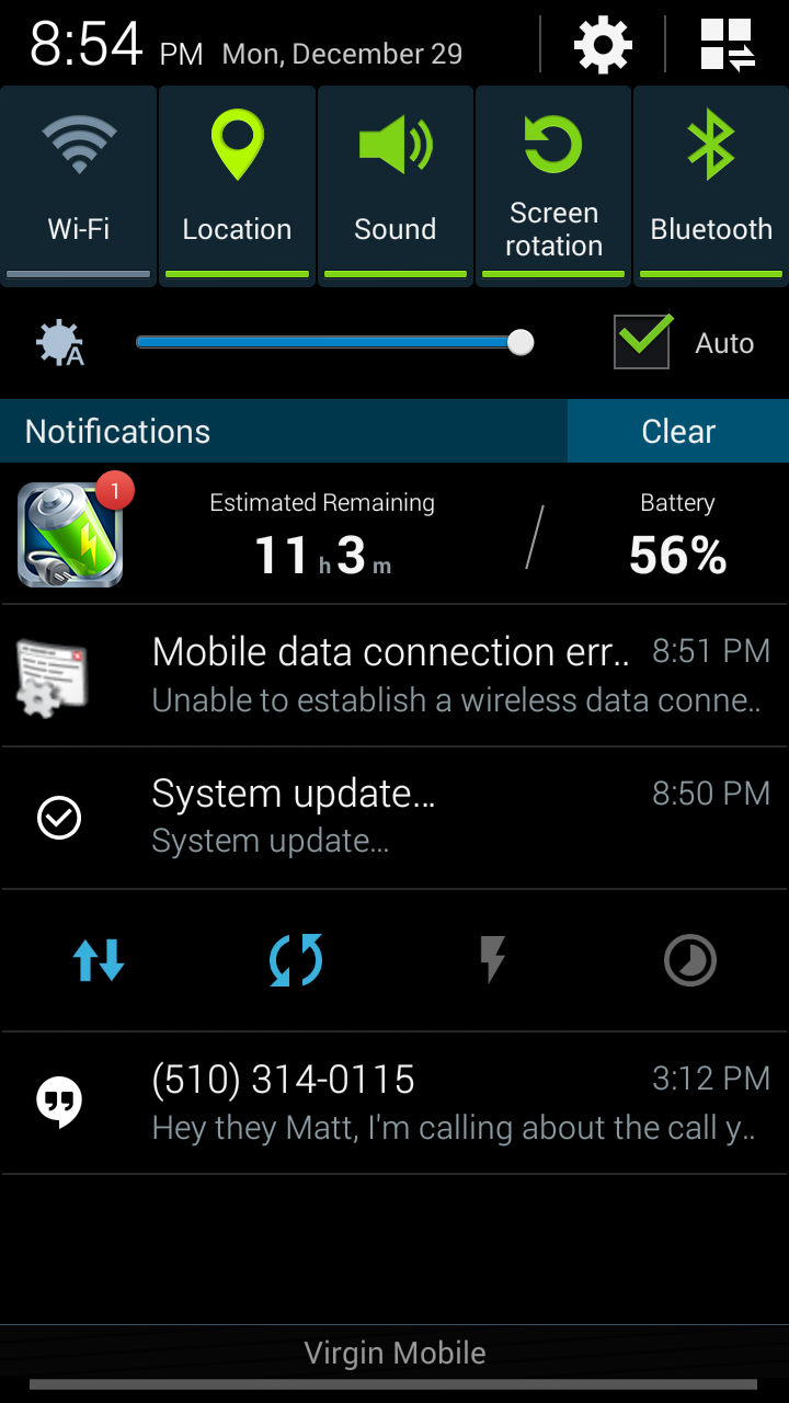

Attached:
1. HTC LTE error message
2. Galaxy S3 LTE error message
3. Persistent "System Update…" notification message

Attached:
Hey, press and hold on that "system update" notification. Then tap app info when it pops up. When it takes you to that apps info, clear the cache and data for that app.

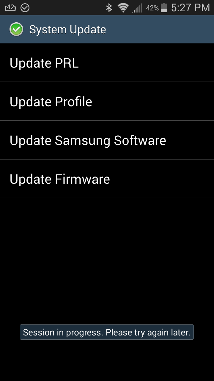

Okay. I just cleared the cache and data, however it still won't let me access Update PRL or Update Profile. Is that what you were trying to do?
The "System Update…" message reappears in the notifications when I try to access that menu again. When I try to select Update PRL or Update Profile, it says:"Session in progress. Please try again later."

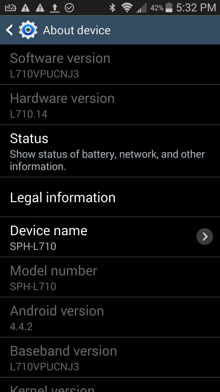

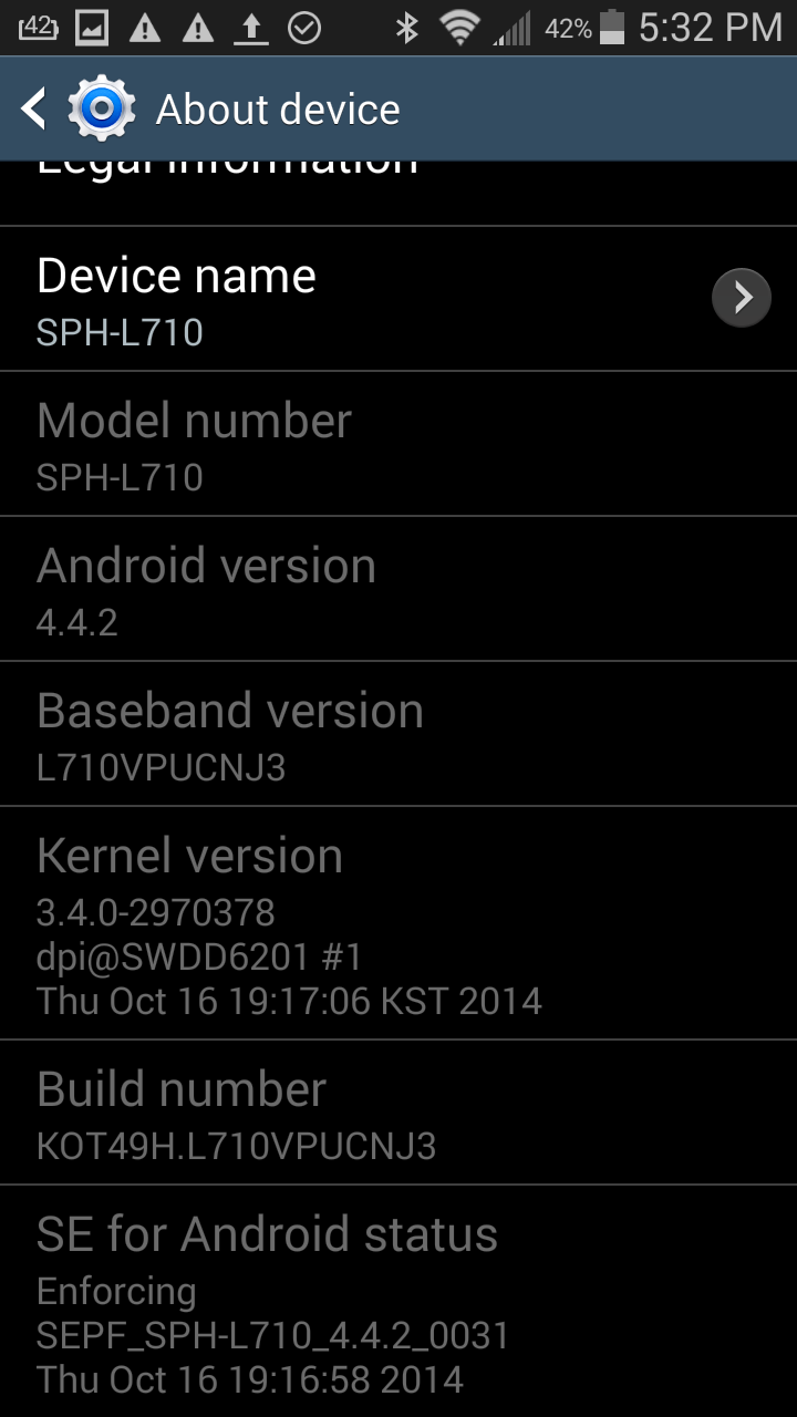

I'm on 4.4.2. Here are my about device screens captures:
View attachment 79616 View attachment 79617

By the way, you are on nj3. We are talking about the last 3 digits or letters in your baseband and build. NDC, nd8, nj3; they are all 4.4.2. So saying 4.4.2 isn't very specific.
