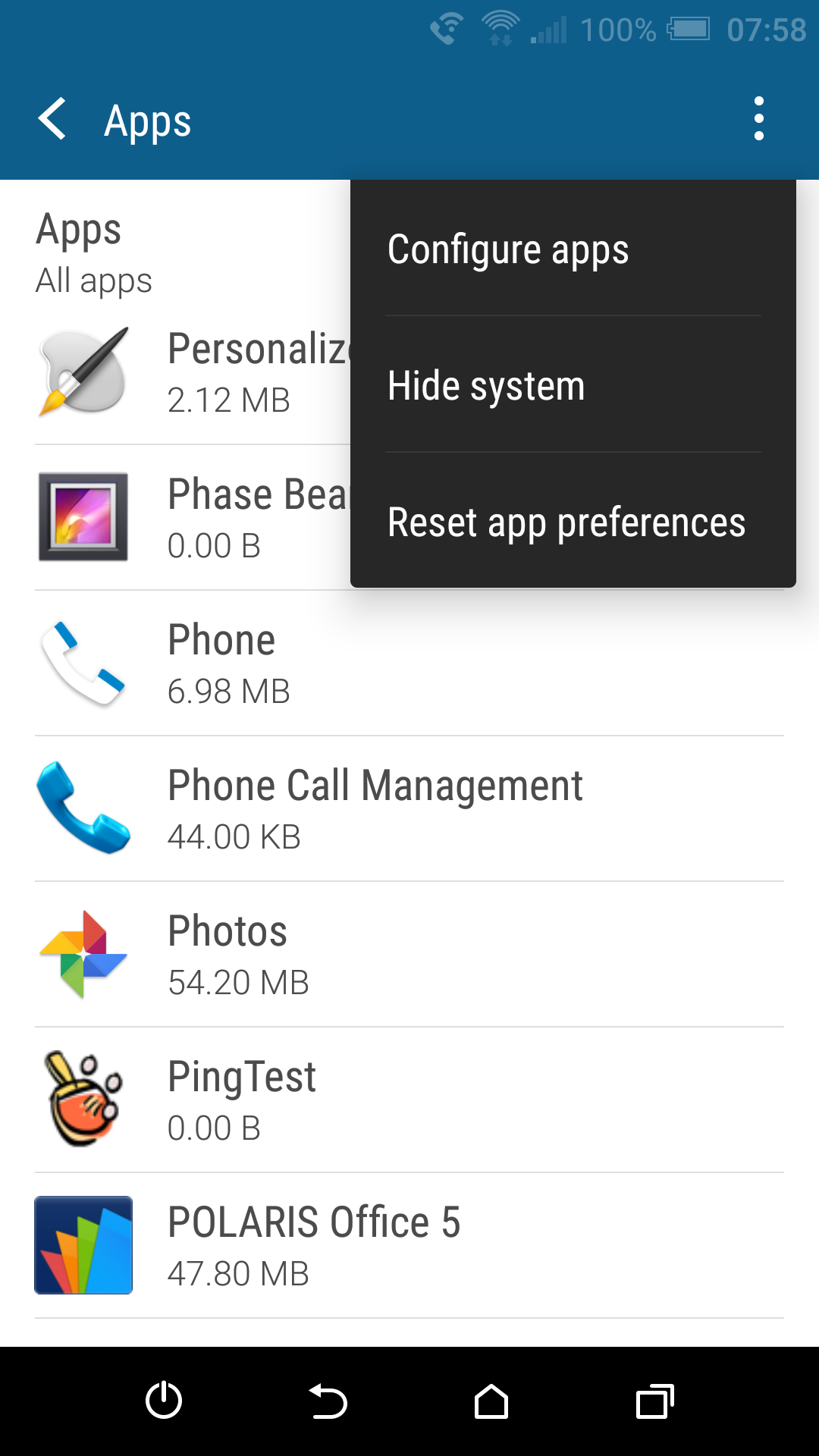

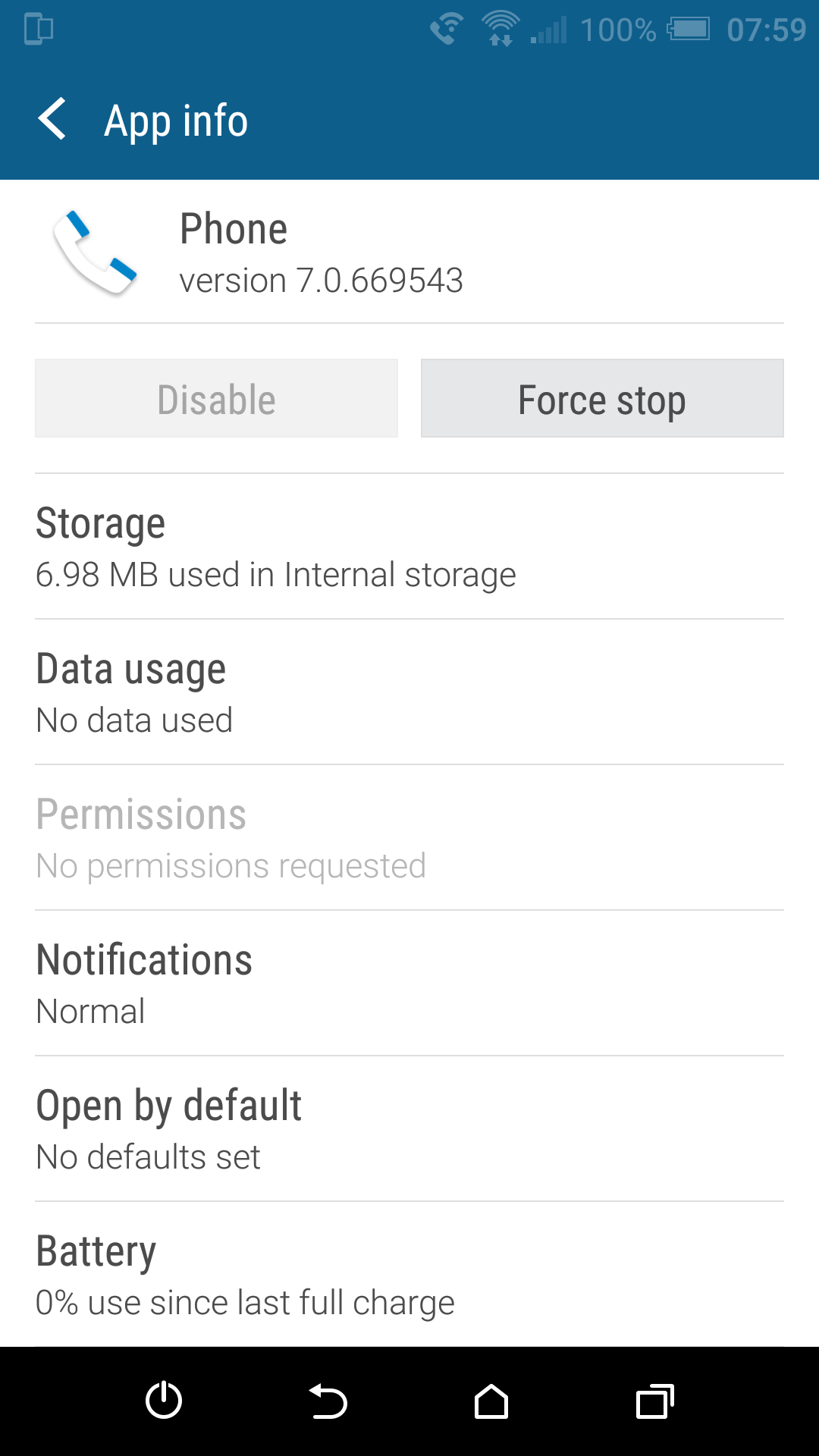

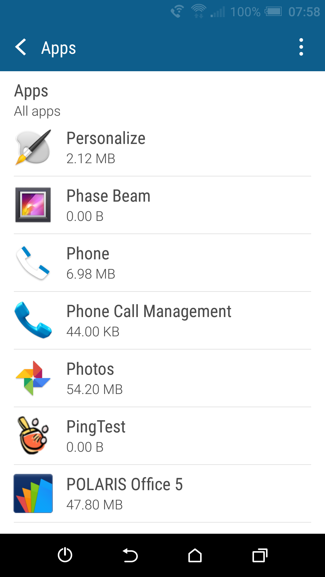

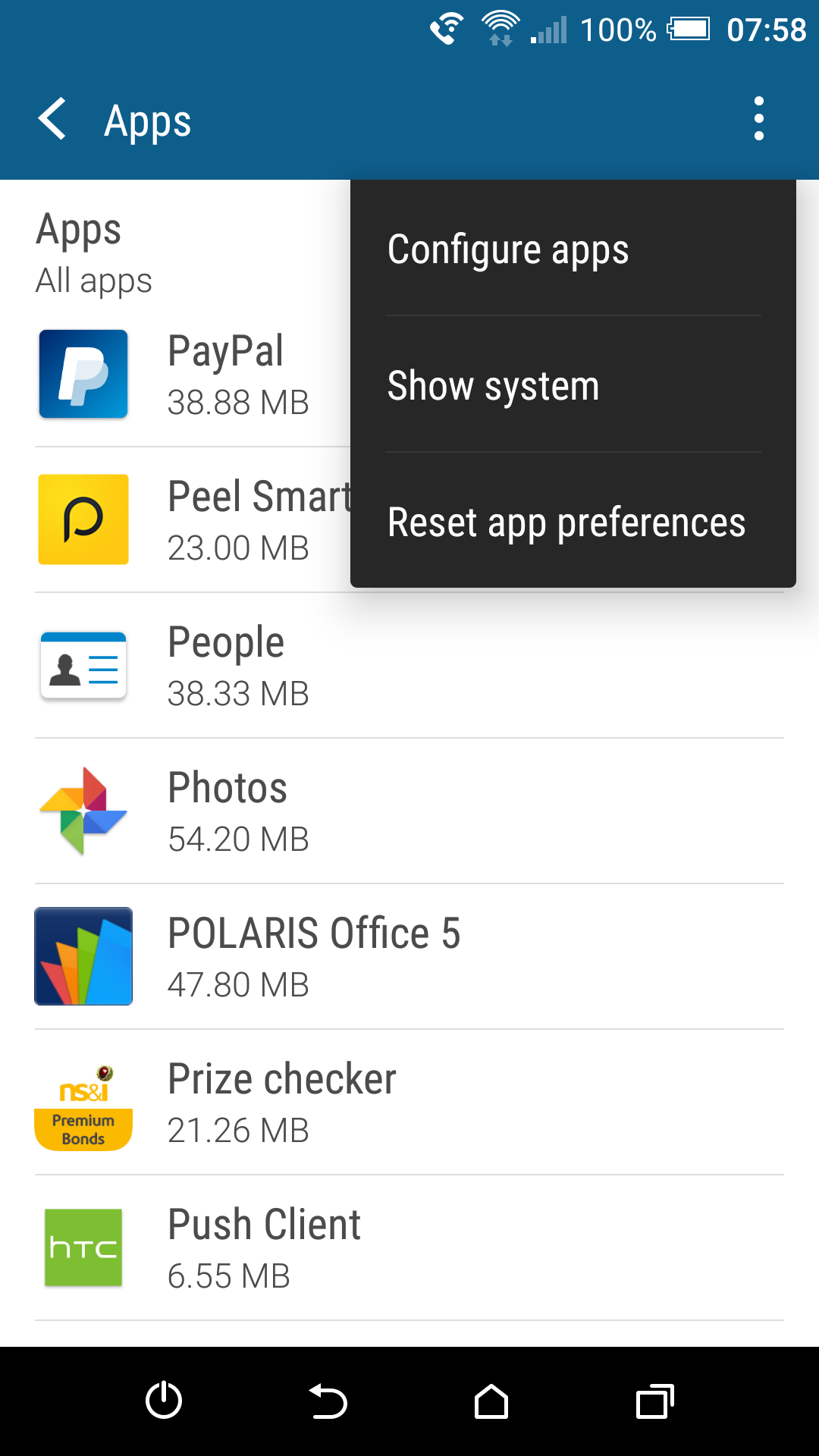

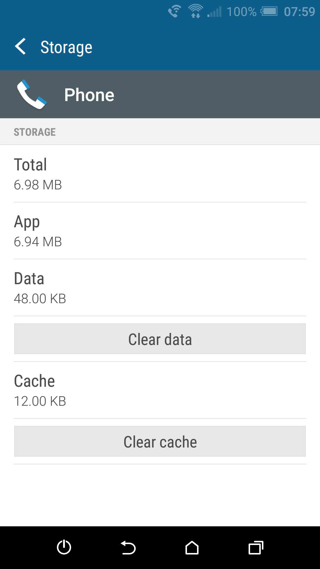

It refers to the 'Phone' app. To get to the phone app in the app last on my M9, I have to 'Show system apps', which you may not be aware of.
So the only suggestion I have at the moment is to try clearing cache and data and possible 'Force stop' the phone app followed by a re-boot.
