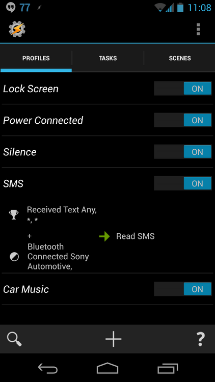

Profile: SMS (4)
Event: Received Text [ Type:Any Sender:* Content:* ]
State: Bluetooth Connected [ Name:Sony Automotive Address:3C:07:71:0C:5F:75 ]

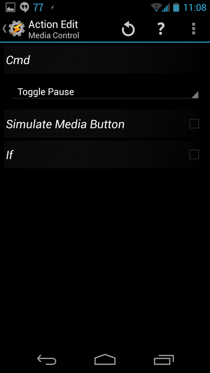

A1: Media Control [ Cmd:Toggle Pause Simulate Media Button:Off ]

A3: Media Control [ Cmd:Toggle Pause Simulate Media Button:Off ]

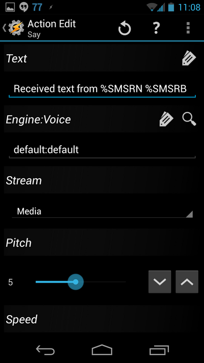

I can attach a few screenshots of how it looks in Tasker if that helps. Just give me a few minutes (at work atm). I will edit this post accordingly. :)

A1: Say [ Text:Received text from %SMSRN %SMSRB Engine:Voice:default:default Stream:3 Pitch:5 Speed:5 Continue Task Immediately:Off ]
Create the test profile and name it "SMS Test", then select "event" as your context - then "phone" - then "received text": leave all fields as they are, it should have "any" under type as default.
Hit your back button to save and create a new task and name it "Read SMS Test" (or whatever you like).
Now click the "+" to add your action - select "misc" - then "say" and in the blank field under "text" enter: Received text from %SMSRN %SMSRB
