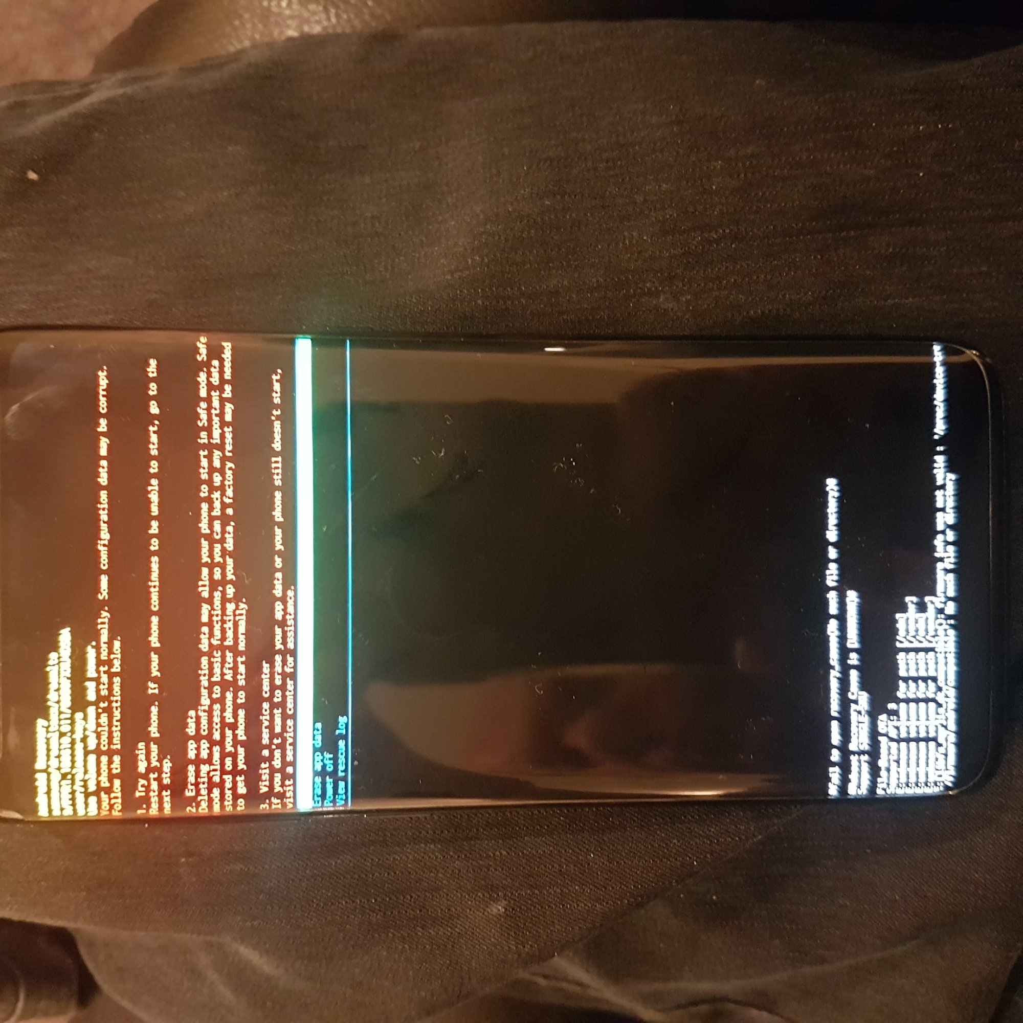

After downloading an update my phone has come up with this screen. I have rebooted and powered off but to no avail

That's not good. Booting into recovery mode like this might mean just that you have some data which are incompatible with the new software, but it may also mean that the update wasn't installed correctly.
The first thing I'd try is erasing the cache. Unfortunately someone (probably Samsung) has tried to make this "friendly" by introducing non-standard wording: I can't see a "clear cache" option, and don't know what "erase app data" means: it might be a silly way of saying "clear cache", but it could clear more than that. I cannot see what option is highlighted in the picture as it's unreadable.

3) If you can't, then do what it says on the recovery screen: try the "erase app data" option (unless perchance the unreadable highlighted option is to clear cache/temporary files, in which case try that). Then see if it will boot normally.
