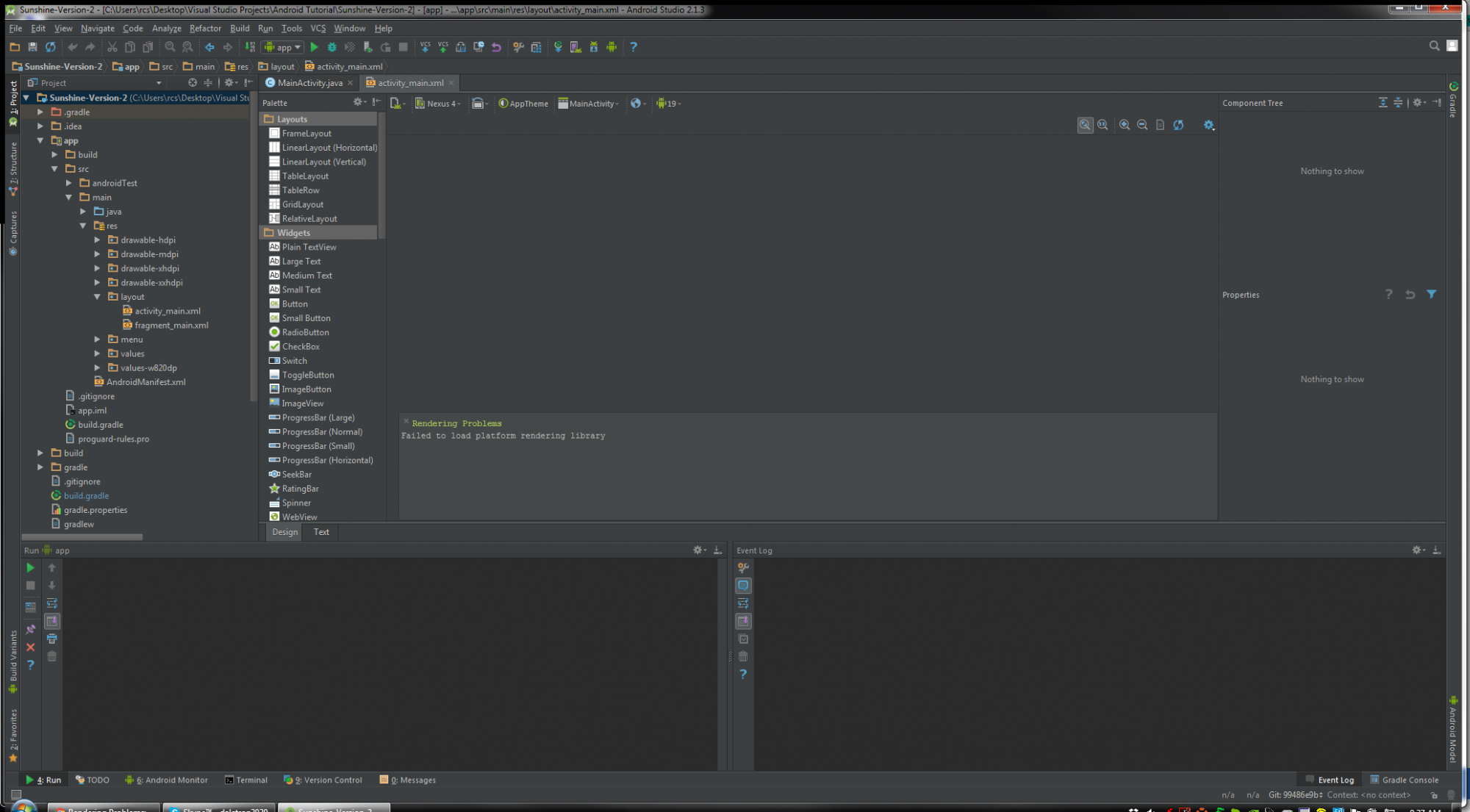

Hey guys I'm pretty desperate here.. I tried asking this on SO but can't get anyone to help...
So when I try to view any of the xml's such as activity_main.xml, in the Design tab or the Text tab where it's supposed to render.. i get this message
"Rendering Problems
Failed to load platform rendering library"
Everything I google says to drop API levels to match the minimum level (by clicking the green Android button with the number next to it).. which I have done. I've tried making different projects with different minimum API/OS versions and I can't get past this error.
I've even downloaded EVERY API level in the SDK Manager.. from lvl 7 to 24.. and none work. I try to clean the build and then rebuild.. just nothing is working and I'm going insane. Someone please help =[
EDIT: I found this in the log which I believe is part of the problem
2016-09-07 12:04:24,724 [ 10617] INFO - .android.sdk.AndroidTargetData - File C:/Users/rcs/AppData/Local/Android/Sdk/platforms/android-24/data/res/values/attrs.xml is not found

hey LV426, thank you so much for replying.
I attached a screenshot. I get this error no matter whether it's a brand new project, or I'm opening a project someone else made.
When I open activity_main.xml or fragment_main.xml... i see NOTHING in the Event Log nor Gradle Console.
When I look at the XML for either of those files I see no red errors neither. I'm really stumped and frustrated

So I installed on my home laptop and it's working.. which is really darn slow and i need this to work on my work laptop.
I definitely tried that latter option a million times
That first link though.. I'm looking at the log and I did notice this
So i guess that might be something? going to start looking into it... do you think that's related?
EDIT: I just navigated there and the file is definitely there.. so i dont know if that's it or even related..
ok i tried to open activity_main.xml again and it definitely logs that error.. so taht definitely is related.. BUT it's weird.. i have the API chosen to 23.. but it's looking in android-24 folder. any suggestions on what i can do to fix this?
EDIT: ok well i changed it to API lvl 19.. and did File --> Invalid Caches / Restart and then it looks in the API-19 folder.. doesn't find it.. but then it switches to 24 again strangely.. and still doesn't find it.. even though they both exist
