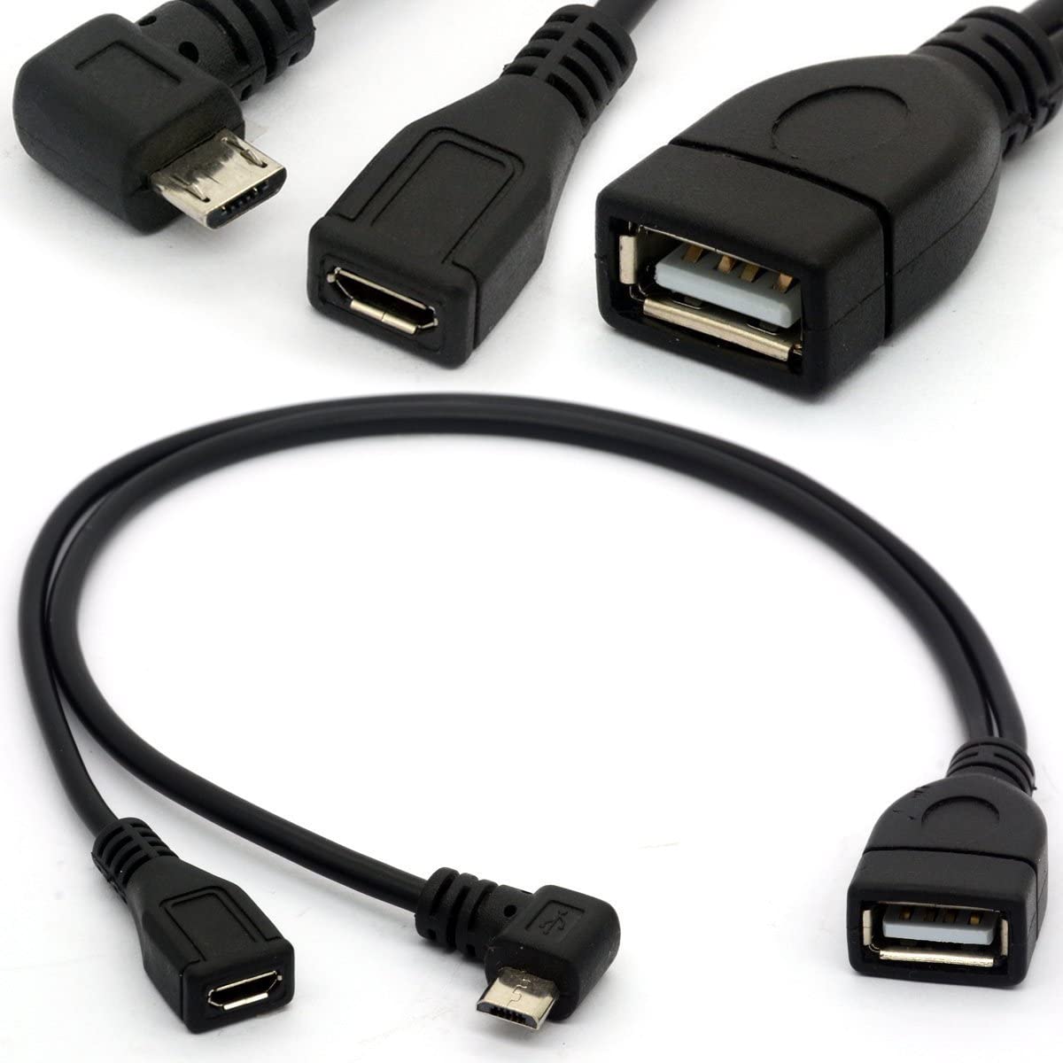

Hi, thanks for the interest. Sadly the J7 Prime is not MHL compatible. I unlocked it via OTG-Keyboard and after that fingerprint works fine. But no tactile response whatsoever. So, I was wondering if an splitter such as the one attached would actually work. Seems pretty straightforward to me but my doubt is because Ive read that you cannot OTG and charge at the same time, but you can OTG and connect to PC at the same time?? Anyways, sure it will be easier to guess-click the confirm option than to navigate blind to USB-Debugging

Yes, navigating completely blind will be tricky indeed!
You don't have access to another phone you can use to test the clicking through the mouse while able to see what you are doing?
I don't know about the splitter. As I say, if it were me I'd try it anyway (risk a few £/$/€ on the chance that it will work).
