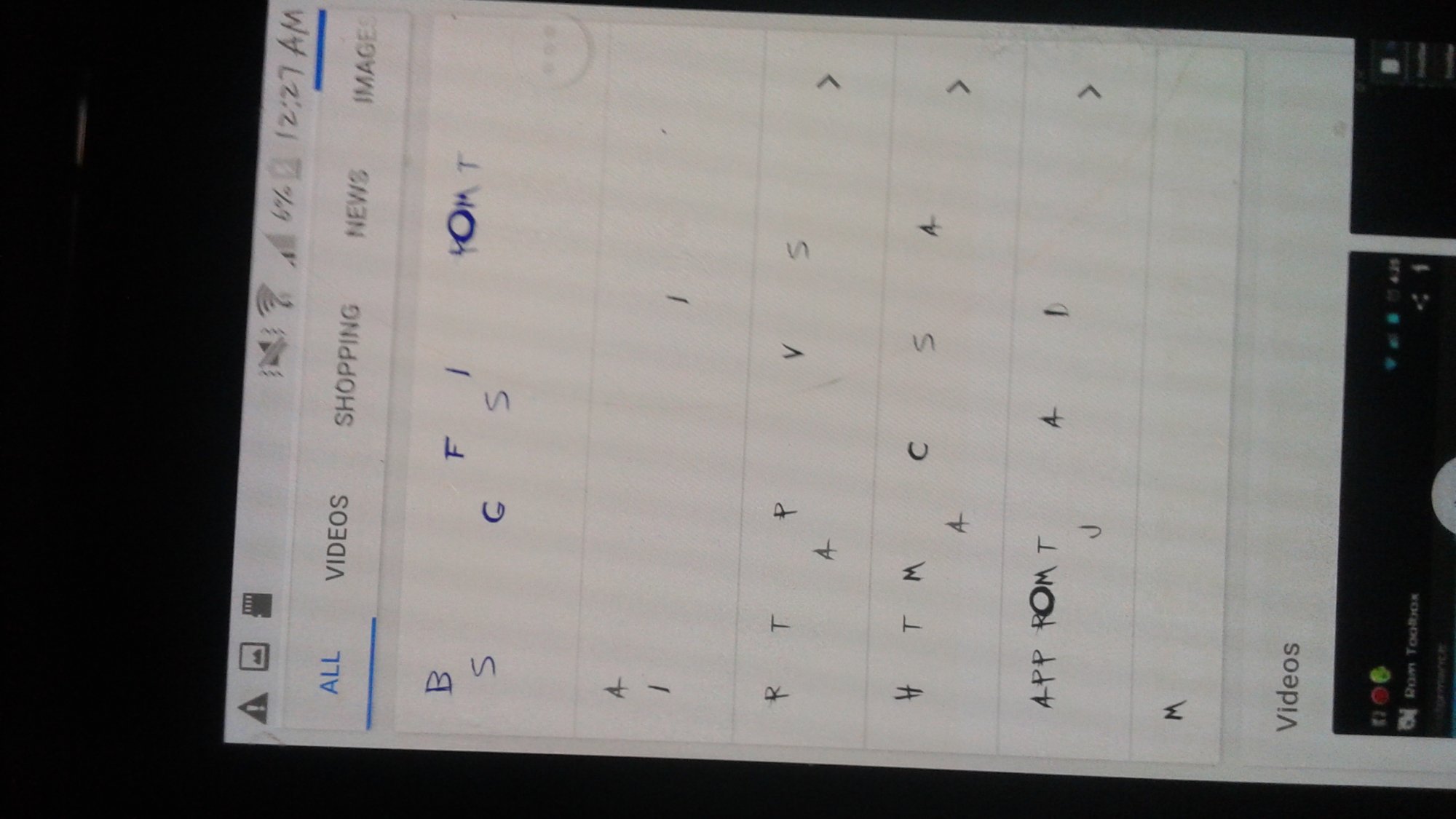

Just recently rooted my S5 and installed Philz Recovery. Made a back up and figured all was good.
I downloaded Rom Toolbox and begun playing around with its features. I changed the font and noticed it's too hard to read so I went to settings and reset my font back to my desired font. Thing is when I load My Internet browser I'm getting half ass font from rom toolbox and I'm missing text and nothing but lines appear when I try to type a search in.
I chose not to back up from the app, as just previously to rooting my phone I made a back up using Philz recovery. Thing is I've already run the restore once ad that didn't solve my problem. So I'm now running it a second time with hopes it will help fix my glitch.
Can anyone offer any help to my problem?

Here is a screen shot if what my Internet browser looks like. 2nd attempt using Philz recovery didn't change a thing. ..
Thank you kindly for the great advice. Third time i wiped the system partition and completed the restore and its working a treat now! All back to normal after following your advice.
Thanks for the help.
