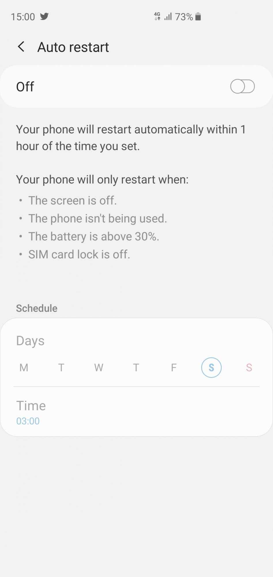

Go into your phones setting page and search for Auto Restart. Start that up and disable it.
This was the closest thing I could find to what you have turned on.

I'll second that, Auto Restart is the only setting I can find on my S9 that does this assuming we are talking about built-in functions and not carrier or user installed apps.
It might help if you specified the exact model # of your S9 as well as your carrier and what Android version. The S9 originally came with 8 but has been updated to 9 although the update may not be available for all models or carriers.
Thanks, my phone carrier is AT&T and yes that's the first thing I'm going to try shutting off auto start and see what happens.
Okay, I figured out what was going on. When the phone did the auto restart after that it was looking for a passcode as a security measure before the phone would turn on. I shut that off and now it restarts and the phone is on ready to go when I wake up, thanks for your help.
