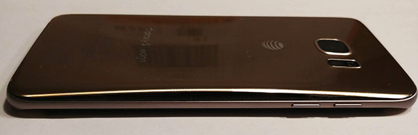

Just one month out of warranty and the battery on my wife's S7 edge swells up and pops the back cover. Samsung's response to this?
"Send it in, we'll be happy to fix it for you. Oh, by the way, there's a charge to evaluate the problem, and a fee for the repair. Let's warm up that credit card and we'll take good care of you."
"AND, just in case we need extra money, those figures I quoted you are contingent upon our techs finding any other problems that we can charge you for."
My, aren't they so helpful?

I have no reservations about opening up the phone and replacing the battery myself, and replacement parts are cheap enough. My biggest concern is going to be losing wireless charging, which Mrs. Luna has come to enjoy since she got this phone.
Update:
New battery kit arrived last night. I took the back off the phone and boy was that sucker (old battery) bloated. It didn't take too much effort to get the old battery out although because of the swelling the outer foil was punctured in the process. Luckily it didn't short (or explode :eek:)
New battery fit fine, put it back together and powered up the phone. After a few tests I confirmed that everything was working. :)
I was sure that because it wasn't an OEM battery that Qi (wireless) charging wasn't going to work. I put the phone on the charger and ... nothing. It took me a few seconds to realize that the wife had unplugged the Qi charger. :mad: She loves to unplug things. :rolleyes: Anyway, after plugging it in, I put the phone on it and it started charging!!! :D :D :D
Before we put her sim back and declare it fixed I want to run it through a couple charge cycles and test it further, but so far, it looks like a WIN for team Lunatic. ;) :)
