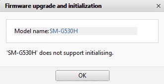

Kies does not support my device.

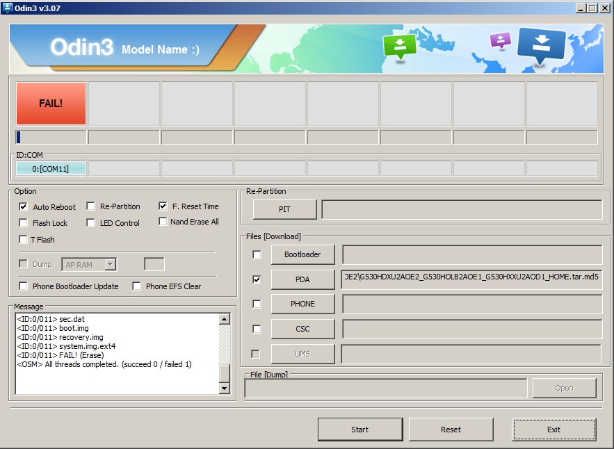

I try to reflash using ODIN using the FW that is stated in the recovery boot G530HDXU2AOE2.
But it failed again when in "system.img.ext4 (please see attached picture).

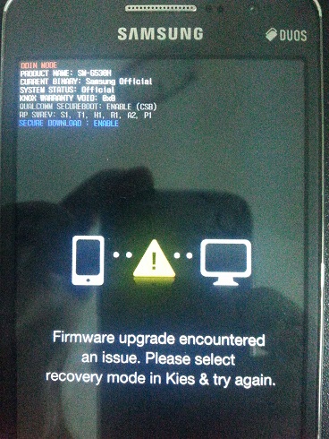

And when I reboot my device the it got stuck on the screen saying "Firmware upgrade encountered an issue" (please see attached picture).. Please help me out I don't know what else to do, huhu
