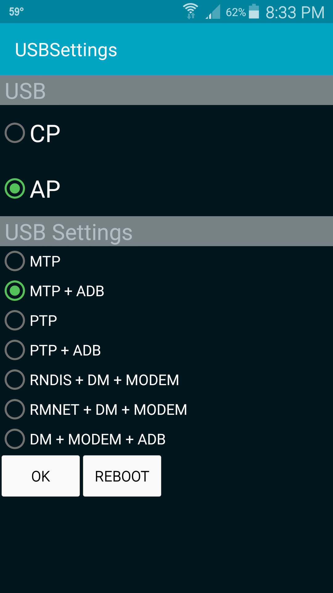

You can also check the USB Setting in the hidden menu. One of these codes should work.
Older Samsung phones was *#7284#
Newer Samsung phones should be *#0808#
Open your phones dialer keypad and enter the code. After the last #, should take you to USB menu. Make sure MTP+ADB is checked.
Settings shouldn't change after you set it. Every now and then, one slips through the cracks and gets shipped from the factory with the wrong settings.
