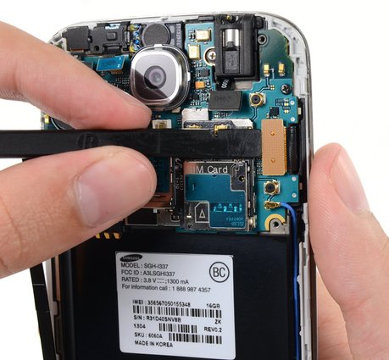

-- Since you can hear the boot up process but not see anything on the display, there's a chance that perhaps the little ribbon cable between the motherboard and the display just became disconnected. A S4 is pretty dated so that wouldn't be too surprising to happen after so many years. (... not likely but not a rare thing.) This jpg attachment shows the actual connector, you might want to just try re-seating it to see if that makes any difference:
This iFixit guide shows you the steps you need to do to get to the connector (ignore the actual tear-down, just use the guide to open up your phone enough to get access to that connector -- see step 13):
https://www.ifixit.com/Guide/Samsung+Galaxy+S4+Display+Assembly+Replacement/16540
