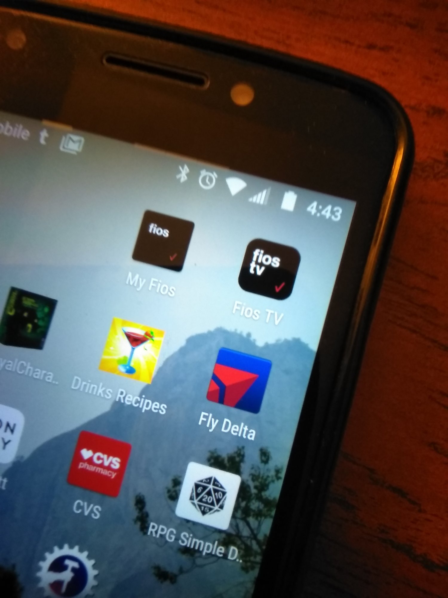

Okay, so...this is the issue I'm having.
Abruptly (I HAVE dropped the phone in the past, haven't we all, but not recently) my phone has started producing thin silver rectangles at the very top edge of the screen. It started with one, and now it's up to four, they're exactly the same size. They seem to be reflective, and are more visible in dark light.
They're visible even when the device is off, so it's clearly hardware.
It's probably not worth getting a screen replacement on such a cheap phone (but it's only a year old, so I'm quite irritated. JUST out of warranty). Is there anything that *would* be worth trying? Is this likely to spread so my phone becomes unusable? (Budget is not there for new phone, but personal safety requires working phone).
This is the best image I can get - taking pics with a tablet camera isn't easy.

If it doesn't get any worse, then I'm living with it. It's a $50 phone, not worth replacing the screen. Anyone else have any experience with this? It HAS been getting worse over the last few days or I wouldn't be so worried.

Well I have an E4 (the lessor of an E4 Plus) and it's still working fine as is. Any phone that's been dropped is more likely to fail sooner rather than later, the good thing being in your situation it was a budget-class phone and not a flagship.

It is absolutely in a case. I'm thinking it might be a loose screen connector, and unless it gets worse I'm going to live with it until I have other reasons to replace (battery life is still perfectly fine and it's still getting sec patches. I mean, battery life is starting to drop a little, but it's not really causing me issues yet).
Yeah, I wouldn't rule out the display-to-motherboard connector being a likely cause. If you're comfortable tearing down your phone, iFixit has some really good, step-by-step guides on repairing a lot of different models. If you take a look at this one:
https://www.ifixit.com/Guide/Motorola+Moto+E4+Plus+Motherboard+Replacement/106273
and look at step 11 there are pics of the actual connector. It might be worth the bother to just re-seat that connector.
I'll think about it. I'm a little wary of performing surgery when I don't currently have a backup handset, but it might be worth trying if it does get worse.
