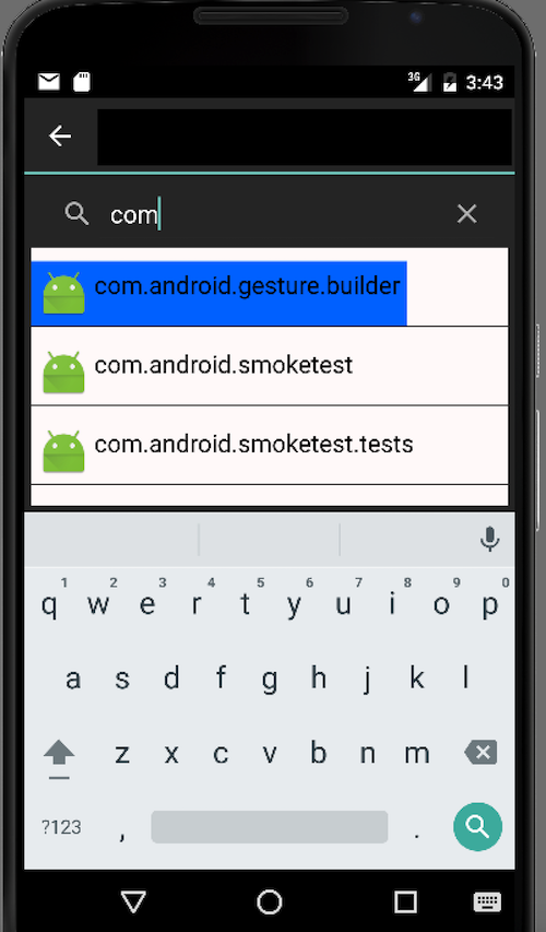

I am using multi choice mode to select the items in the listview with filter. After searching through the list view when I select an item it highlights a different position instead of the original position of the item in the list view.
For example:
1. With filter, I’ve selected the following item:

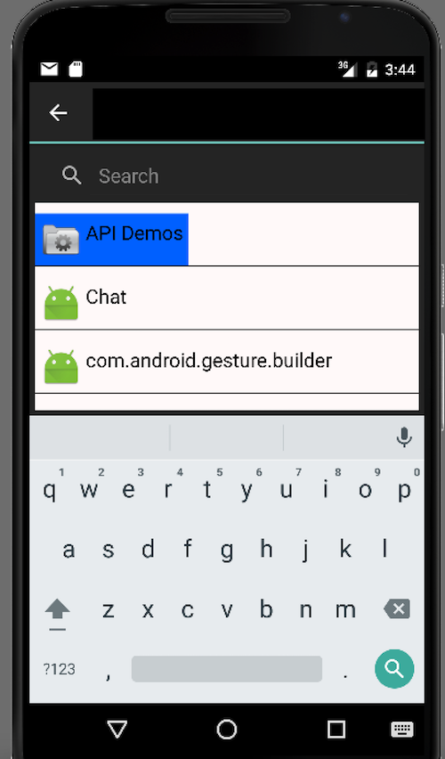

2. On the main list view with no filter, it does not highlight the selected item, but the wrong one:
In the below code of my Main Activity, how can I achieve what I’m looking for:
