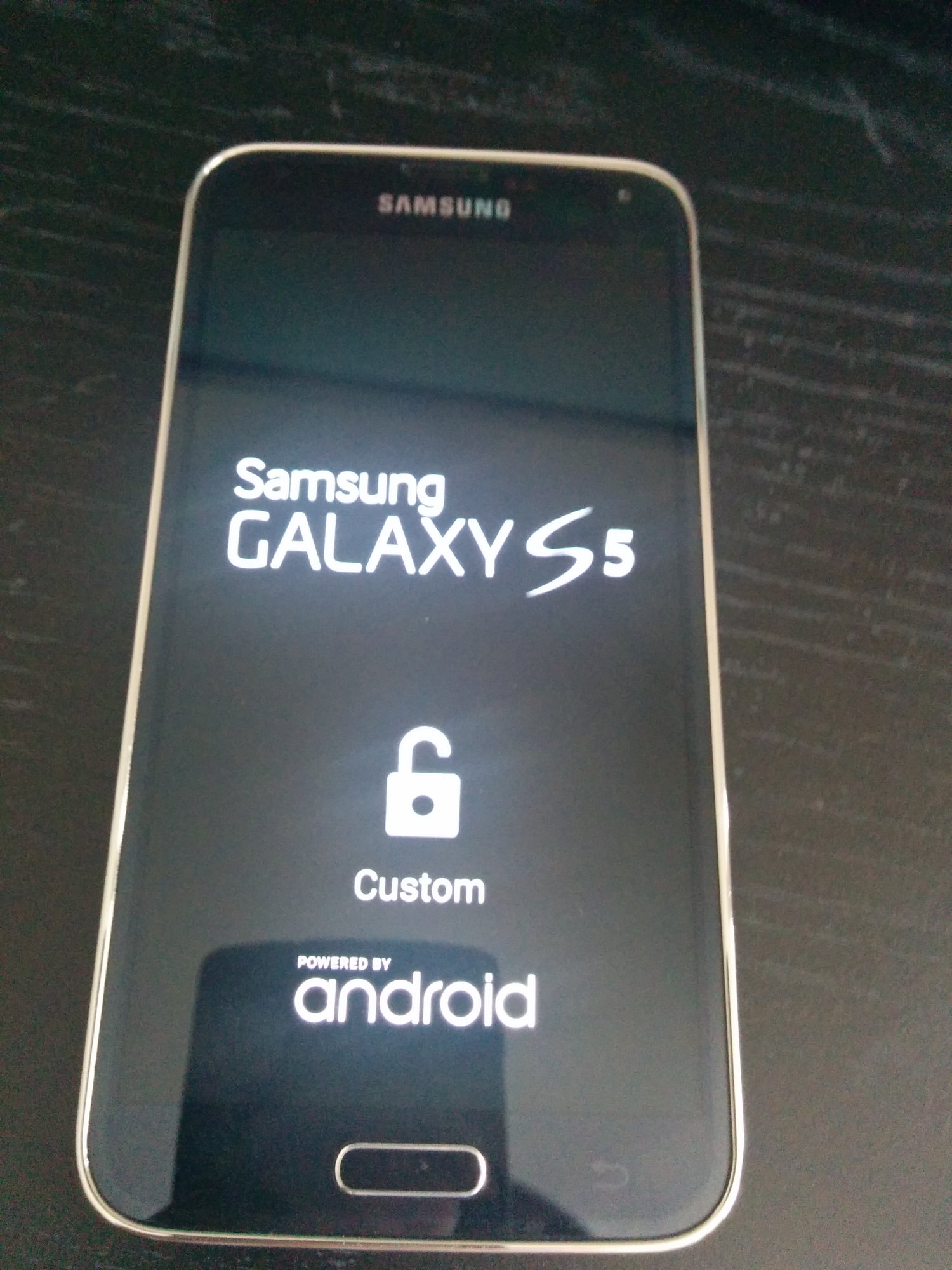

Hello, i got an S5 that i bought, and the phone came rooted with safetrap & Custom rom, so i tried to bring it back to stock rom so i went and downloaded a firmware and did the odin installed, after it finish installing the stock rom, it booted but got stuck on the samsung logo.
I went and to the stock recovery and deleted data factory reset and cache deleted, so i rebooted the phone again, and i still get stuck on the samsung logo.
What can i do to fix the problem? The phone still shows an unlock lock icon when it's going to reboot.
The stock firmware that i installed via odin3 was SM-G900A4.4.2

Finally i got it fix, after hours of searching i finally found the firmware i needed to get out of the semi-brick. i will explain how i did it, just in case someone runs with same issues.
my phone had NG3, so i found a thread on xda that said "Should the NG3 ota update fail consider returning to stock NCE by flashing the G900A_Downgrade_to_NCE.tar using Odin's PDA slot(AP in Odin v3.09+)" so that's what i did i downloaded the G900A_Downgrade_to_NCE.tar, intalled it via odin, and my phone booted with no problem on a new stock rom.
