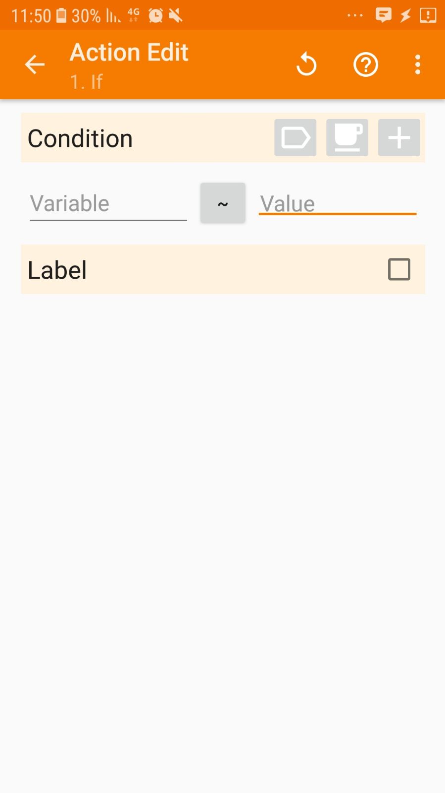

i have problem in defaying the hour in if then
which varible or statment should i write to get the hour trigger in if then
in this screen that i attached in the file

tom all i am asking is
you have dayw-for choosing the day of the week
you have daym-for choosing date
what is varible for defaying hour in if then flow
It is %hour in the following task …
