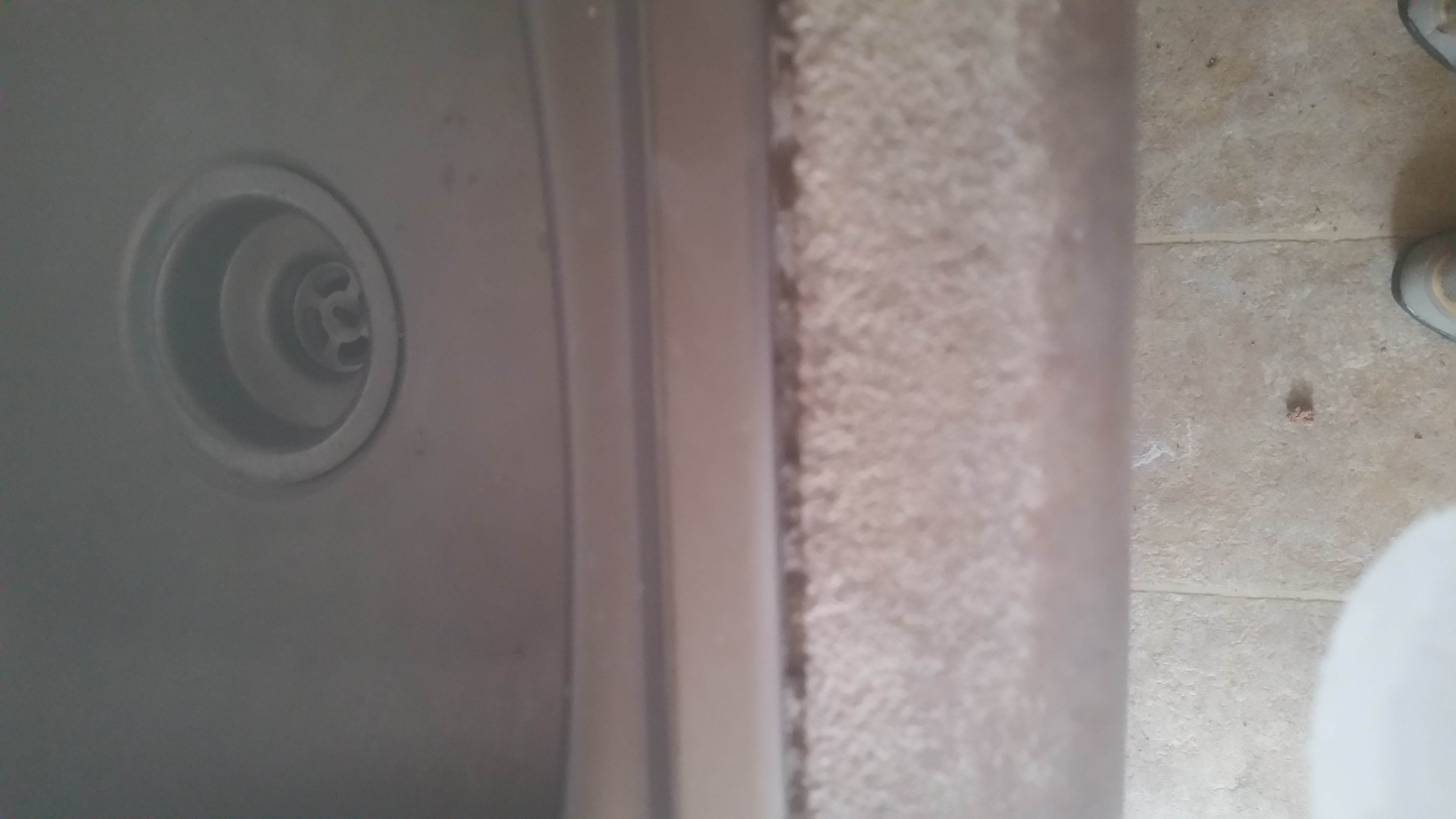

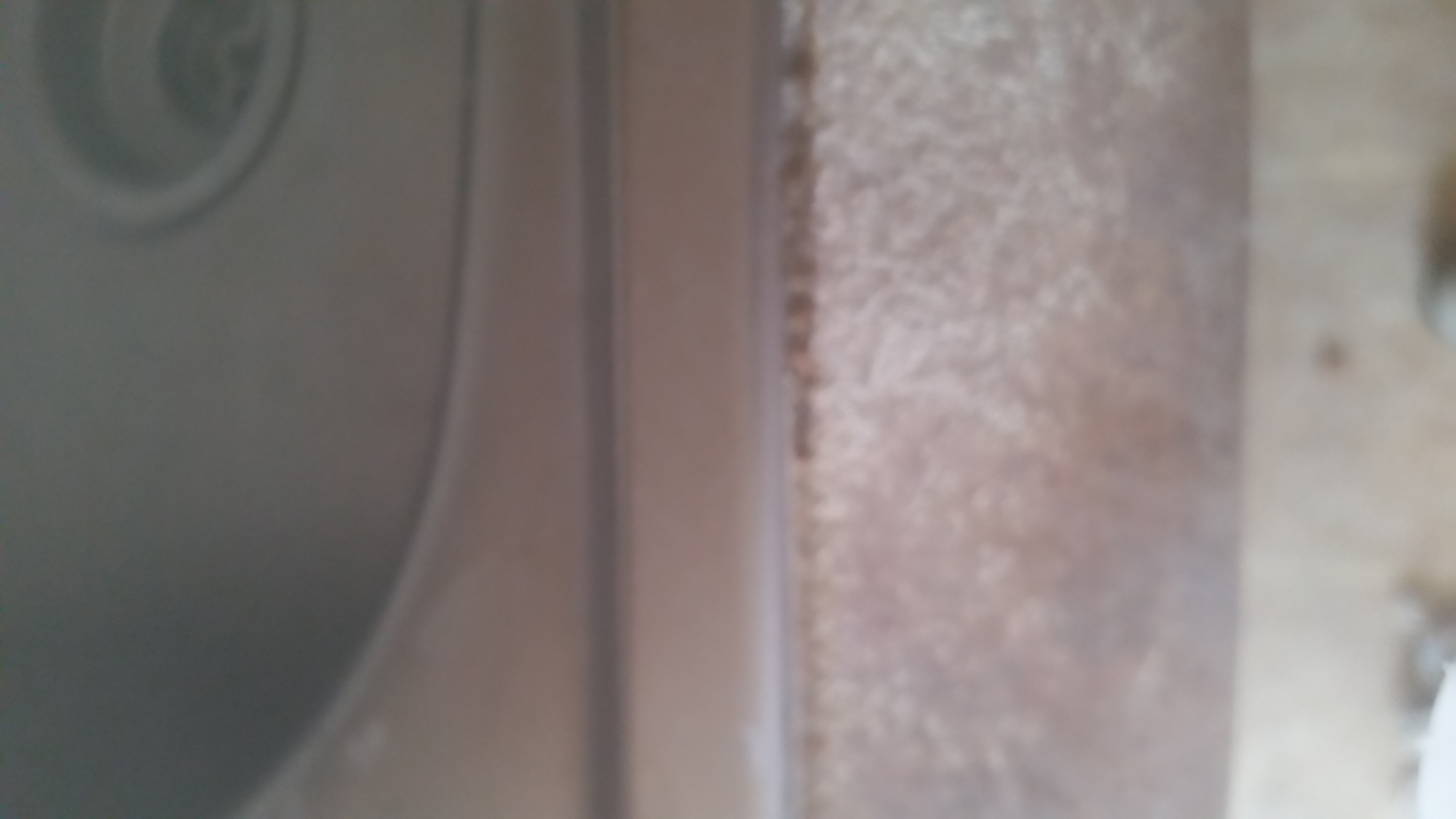

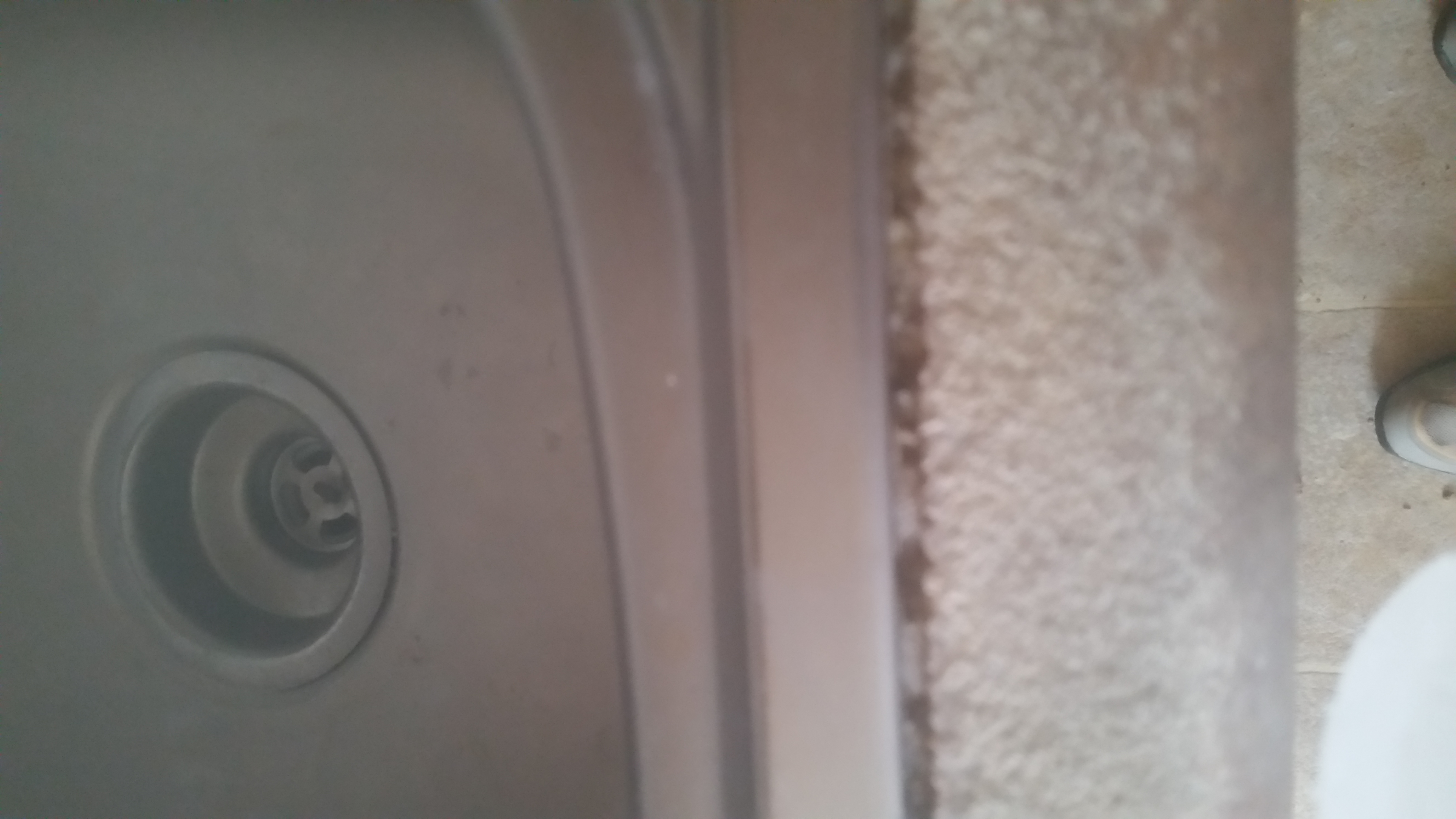

It's the edge of the sink, which I guess is ok, and the counter, which is not. You've probably noticed I'm not much of a photographer. The counter is probably kind of old, maybe formica. I should include a photo of an undamaged part for comparison.

I'd clean that edge really well to get any old caulk out and also to remove any junk. Clean it well with some alcohol and let it dry. Get some good water resistant, kitchen/bath caulk (I like latex not silicone based myself), in the color of choice and apply it. Let it dry to manufacture specs and enjoy :)

Would Dap work? I have some but I think it's just plain white. I haven't opened it yet. Could I color it to match?
As far as the latex based bit, the reason I like it is because I find it easier to clean up with water and also to smooth it out with a wet finger :)
DAP is good, I use it too. Coloring it....eh, not sure you could do that with a caulk in a tube...a bit hard to do, just get the color of choice. White would be fine if your picture depicts the right color :)

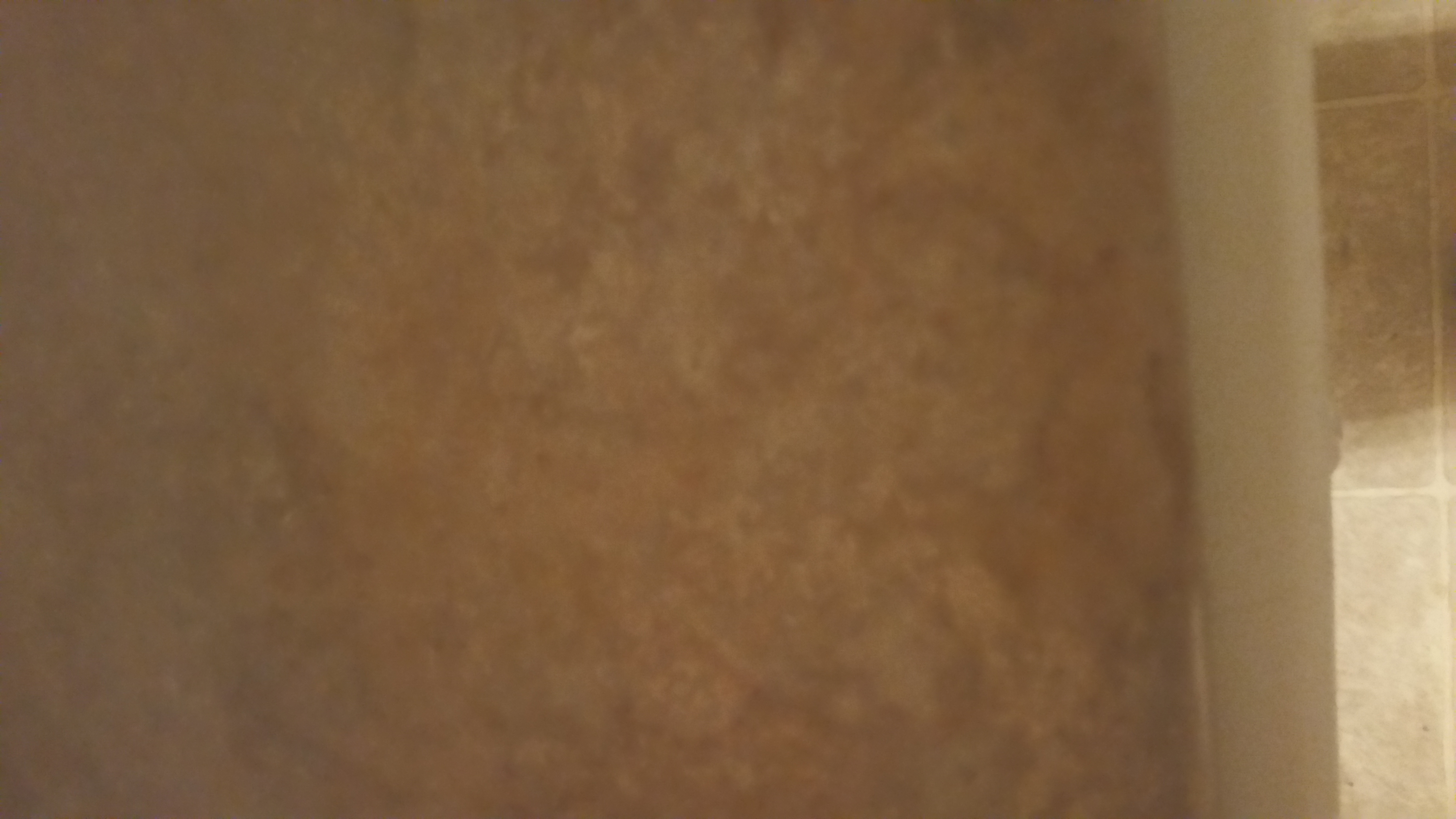

The rest of it's sort of mottled tan or something. I think it's supposed to resemble quartz. I bet they don't have that color combo.
