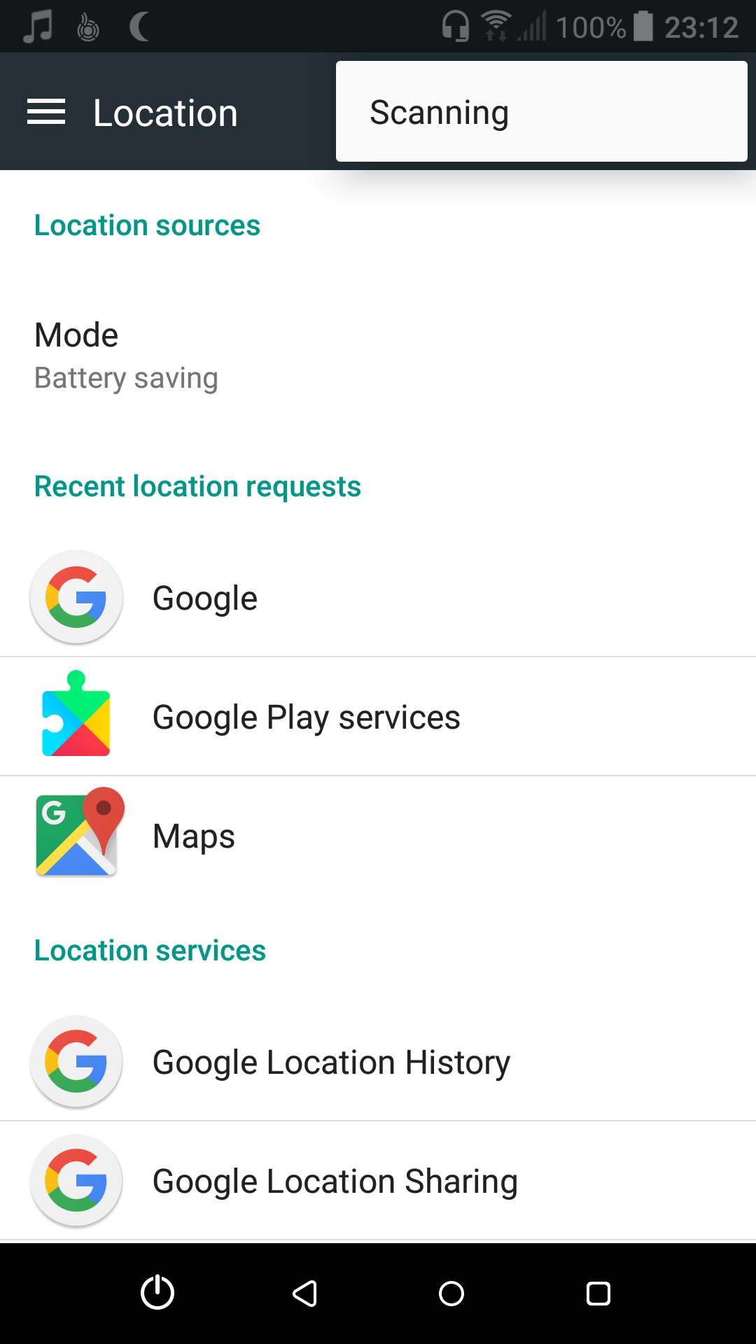

It may be worth checking your WiFi scanning setting in 'Location' settings. If it's ON it will keep scanning for WiFi access points even though you may have WiFi switched off.
Screenshot_20171001-231139.png Screenshot_20171001-231153.png Screenshot_20171001-231209.png Screenshot_20171001-231232.png
Tap the 3 dot menu button top right then tap 'Scanning'.
