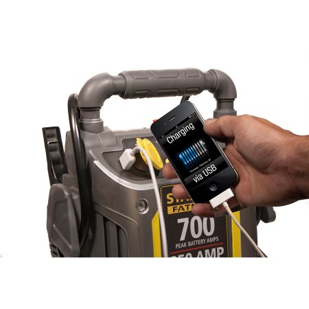

well For about $60 USD I put together a Power supply kit running my PC, a T.V, Charging A phone, and cooking on a hot plate...
( For taking my Stuff With Me Camping --- i know laugh if you want but I gotta be connected)
I used an Approx. $30 Jump-Start box ( for jump starting a car )
and a 200 Watt Dc to Ac inverter (used to run Power-tools from the Battery of a work truck )
a back pack ,
a powerstrip
and a short extension cord (to plug it in to charge it with out pulling it all out the back-pack )
basically I took the Big black wire from the inverter and clipped the big black clamp from the jump-box on it , with a little electric tape to cover it
and the red wire to the red clamp and tape it.
turn the jump box to START
and the inverter comes right on...
it powered the T.V, a Desktop P.c& Monitor , A hotplate or coffee pot and had a usb port right there to power my android with native wifi hotspot :)
while this is a Home brewed solution it did seem to work great, For Hours at a time (3-4) depending on how much coffee or food i heated...
but yeah It worked out great, and would be my recommendation as opposed to the U.P.S because it's portable by design.
