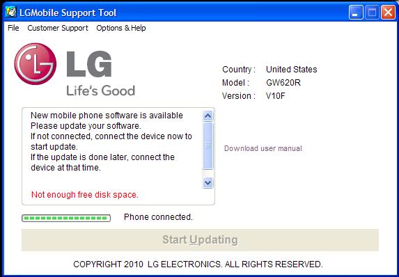

i can't seem to get the 10Q update and i see this pops up. i have 99mb avail on my phone for int. memory left. 'not enough disk space' wtf ??
anyone know what is wrong here? note the start updating is greyed out as well. see attached screen capture.
I believe that the low disk space refers to your computer: I had to move some stuff onto an external hard drive myself.
you were right, the lg software must scan all your hdd's for space, i found my 'c' hard drive was pretty full (my os hdd is 'i') so a reformatted the 'c' hdd and then i was able to do the 1.6 update. took approx 15 min. to do the update.
