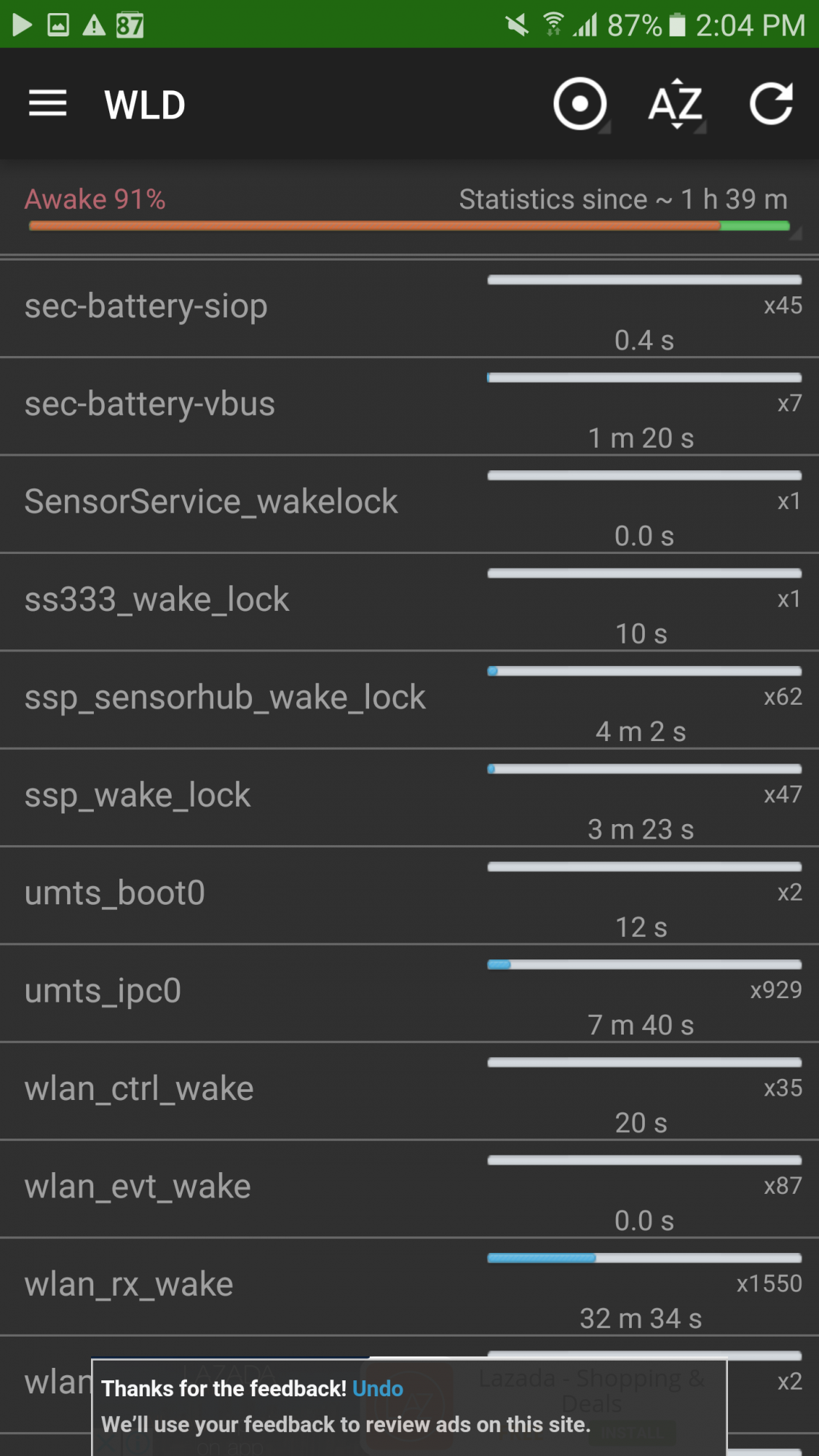

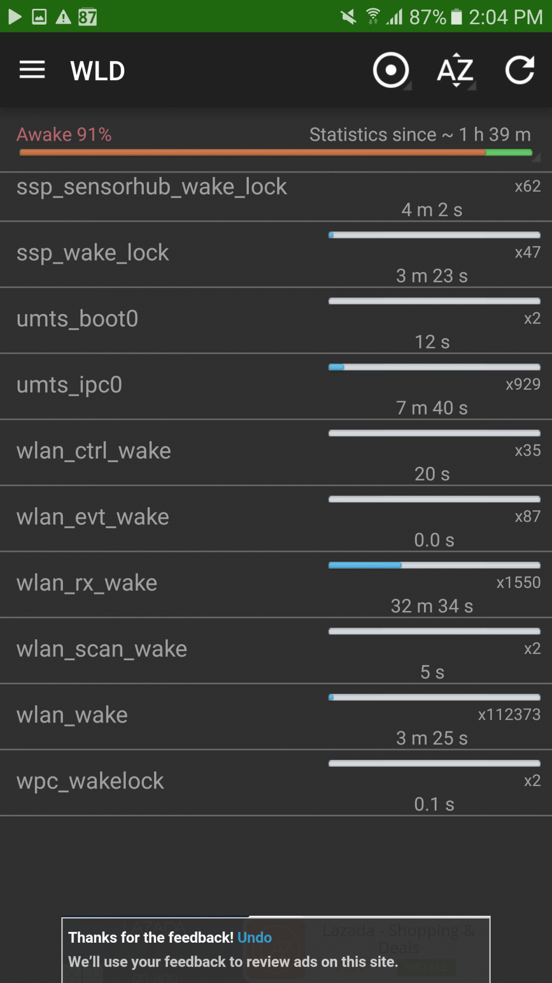

Hello guys i urgently need help like right now ... this is a common problem .. battery problem..first it showed up when after i bought it.. drain fast in lollipop.. now i upgraded it in marshmallow..now my battery even worse.. 60-70% lost overnight.. ever since i found out the draining .. until now i cant find a fix to this please help me.i search everywhere nothing.. followed all things like disabling.clearing.wiping all those things but still no fix. this ****ing android os is always held awake damn .can you help me fix it . here are the screen shots .. i lost 11% for only 1hr and 39 min. Its sucking all the energy.. and for 1hr and 39m ..my deepsleep is only 0.2s?!!! Wtf???!! And sometimes when theres no wakelock.. its only 0.5 seconds :( .. im very frustated and sad .. i dont know why this happened .
all my phone dont drain .. my sisters s6 battery is like a charm . No drain even 1% .. and mine .. for 10 hrs only in idle it will be ZERO..PLS ANYONE.. I NEED HELP.. HOW TO GET RID OF THIS FAQING DRAIN..

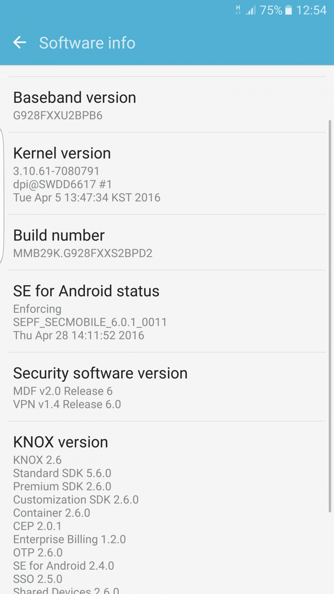

I think it will work for me but my build number will change for sure.it is already stated its for g928f so i think build number wont matter... its worth a try .. i am confused as to why you lost your root access .. adverts appearing is a sign that you lost your su access.. maybe you tampered something but i dont think so.. but maybe that happen because you didnt meet the build number requirements for root.. we dont know.. and lastly can take a screen shot of your build number just to make sure..
Is your build number the same to the required build number in cf? Or after rooting did you noticed that your build no. Changed?

Yes that is the root file I used.
