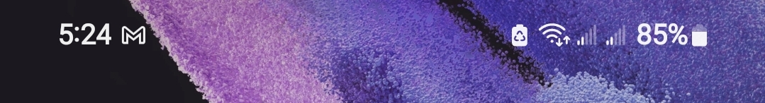

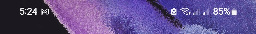

I get both signals for 2 sims though...

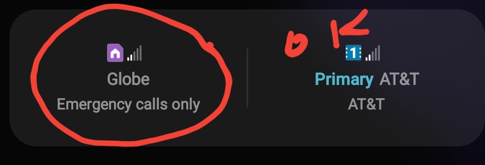

But the international nano sim is on Emeegency call.

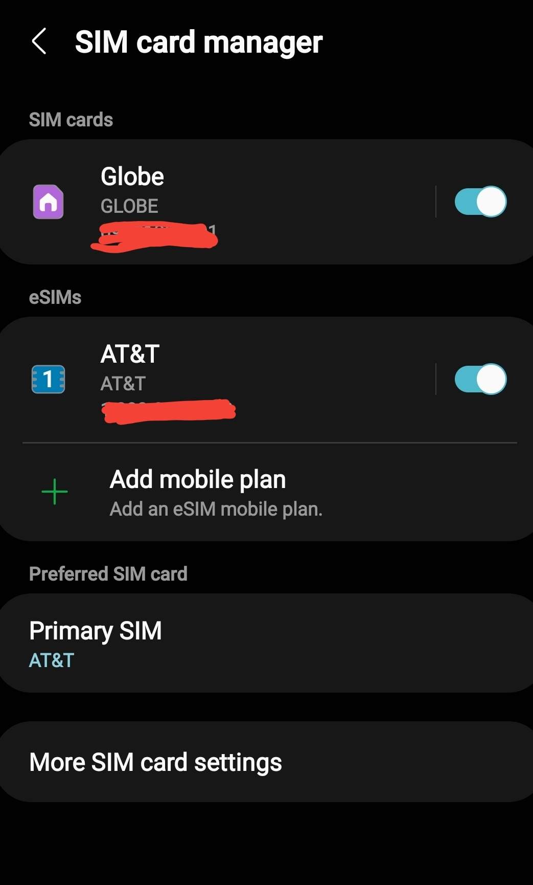

Yes, it shows two sims are active.
The problem right now is that the nano-sim (international sim that connects to local partner network - T-Mobile) doesn't connect to network even tried manual network search for T-mobile does not show. I had the nano sim on this phone (S21) initially and it was working; only after the AT&T ESIM activation that it went like this. Tried the sim on another phone (mentioned before) and it was ok and was able to scan T-mobile network.
What happens if you un-check the AT&T e-SIM, which should disable it temporarily, is the Globe SIM usable then?

I did that before but it didn't worked.
Last night before I saw your post, I was backing up my for a factory reset. Then I saw your post, tried it again still didn't work. I left it (nano sim on and esim off) for probably an hour as I was browsing through my phone to check if I have missed stuff to back up. Then, suddenly I got an SMS from the nano-sim . It was working altrady, then I tried to turn esim on, both are now working! What a relief!
