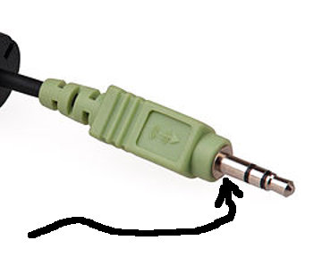

As you've isolated the problem to be specifically between your phone and those headphones, the only thing I can think of at this point is if there's some kind of build-up right up at the base of the headphone's plug end (see jpg)
A headphone jack is essentially just a mechanical, spring loaded switch, with metal contacts that must aligned exactly with the metal contacts on the headphone plug, enabling the audio signal to go to either the internal phone speaker or the headphone. If there's something like an old bit of tape or something right where the plastic and metal meet, it might be just thick enough that it's preventing the plug from being fully inserted into the jack (which will prevent the jack's spring loaded switch from being pushed outward). Kind of a long shot, considering those headphones do work elsewhere but as almost everything in a smartphone is miniaturized that often applies to tolerances too.

To be honest I really can't say, but when you push your headphone plug end into your phone's headphone jack, it really is just a mechanical switch inside. The plug end pushes aside a spring-loaded piece of metal, switching contacts so the audio out changes from the speaker to the headphone/earbud. In addition the metal contacts that make up the shaft of the plug end, in this instance ground, left channel, and right channel separated by plastic insulators, also have to line up with their corresponding ground, left channel, and right channel contacts inside the jack. If the the plug isn't fully inserted, the switch may or may not be moved, and the matching metal contacts might not be aligned properly. Depending on how misaligned they are (which correlates with how deeply the plug end is inserted), there might be only one channel going to the proper output. And really this is way more verbage than necessary, just take a look at the plug to see if it's clean and make sure it's fully inserted.
I can't see anything on the outer rim of either the jack or the shaft getting in the way. Both are clear.
