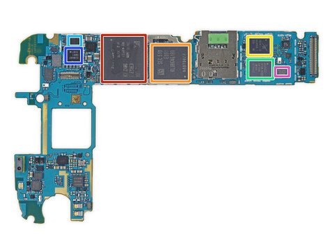

depending on where you currently reside that phone may only have limited cellular connectivity using FLOW. Apparently with some islands there is full 2G, 3G, and 4G LTE support (Antigua and Barbados) while others only 2G and 3G (Jamaica), the issue being a smartphone's ability to use different cellular networks (there are many variations) is partially determined by software but primarily by hardware. More specifically, a chip soldered to the phone's internal motherboard. With a S6, it will be the chip highlighted in yellow:
(taken from https://www.ifixit.com/Teardown/Samsung+Galaxy+S6+Teardown/39174 step #10)
So if there is a compatibility issue with that formerly Sprint S6 with your local FLOW carrier, it's not so much an issue of what they can do on their end, it's just that the phone itself might have conditional limitations (it's a hardware matter).
