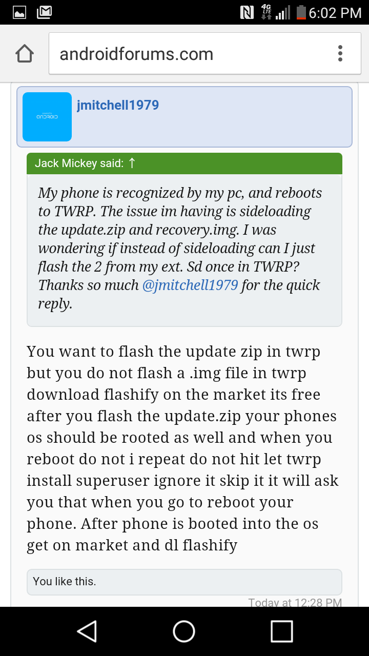

Heres what I was told

Well @tube517 , it worked like a charm!! Thank you kindly. I followed the tut, except instead of installing twrp through adb, i just temporarily booted it. Flashed the supersu zip, rebooted system. I checked for root using root checker. VERIFIED! Downloaded flashify, flashed twrp, and made a backup. I now have stock Metropcs MM with root and custom recovery. Now I will patiently wait and hope that one of you geniuses someday make a rom or CM13 for this device. Thank you again!
