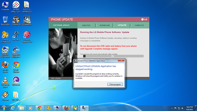

hello tony.. i follow this step.. The updater stop in 4% and tells to stop the program caused a problem it must be stop.. what will i do now?
