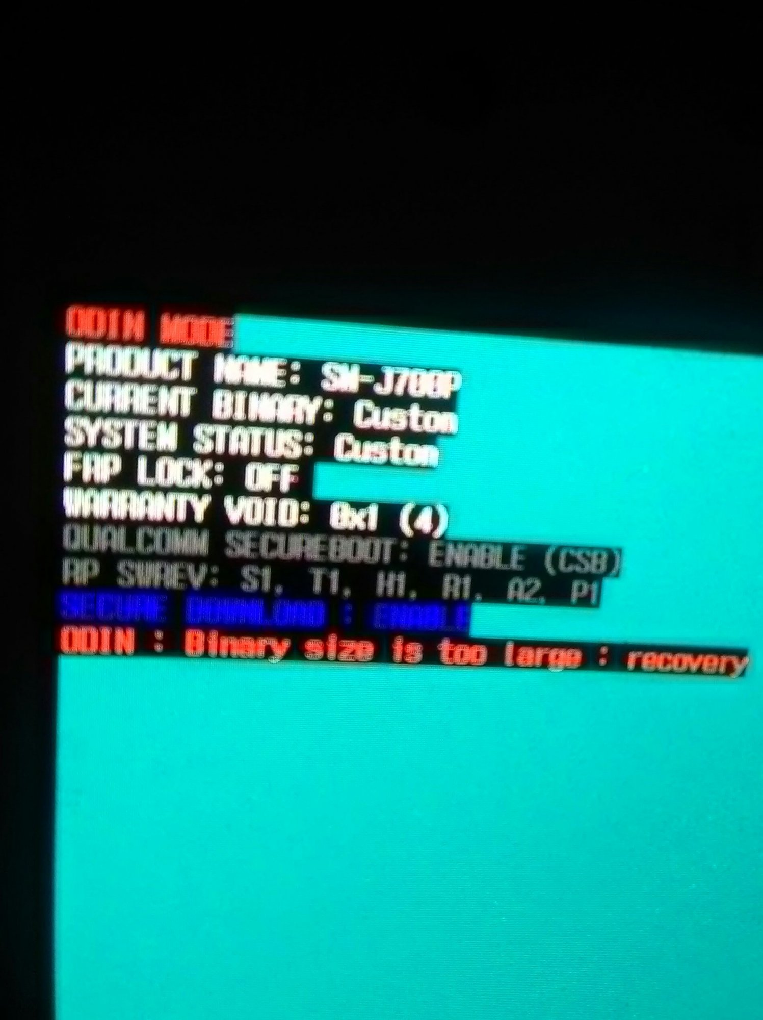

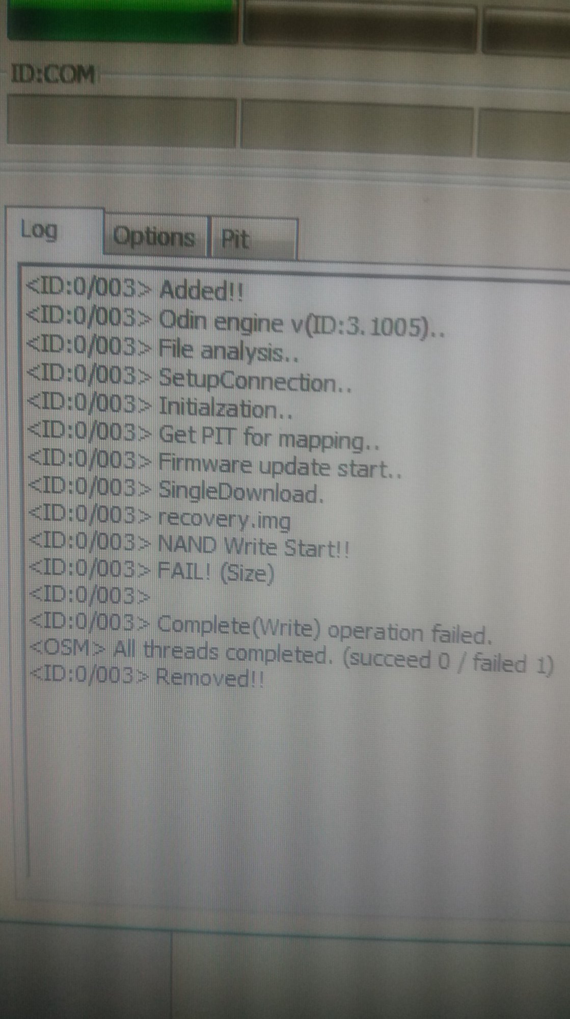

So I have the J7 (SM-J700P) with Boost Mobile. I had it rooted up until I heard about the Nougat update. So, to get the update I had to unroot so it could OTA it. So I did and yes maybe I should have done a little research first but I checked out Nougat which I must say I do actually like defiantly in comparison to Marshmallow which I hated more than I can put into words. Then I wanted to again, root my device. Maybe some of you are like stop right there. Yes, I know now...the best things I have ever learned about rooting is making a mistake, lol. I won't make the same mistake twice that's for sure. Anyway, I end up pretty much soft bricking it but luckily I was able to get the Nougat files and just used ODIN to install and now I am back to Nougat 7.1.1 but I cannot root, or can I? I think I can, just not sure how yet. So now, when I go to root with ODIN it fails. Here is what both ODIN and phone read. Any ideas?

Did you use the same files which you used to root in the first place? I know on my s8 that the bootloader got updated and the old root files wouldn't work. Maybe see if the file to root the recovery or kernel has been updated to match the firmware. If worse comes to worse flash back to marshmallow with Odin, root again and then flash a custom Nougat ROM in recovery

Did you figure it out? I am rooted on Nougat. I used Odin to flash twrp-3.2.1-0-j7ltespr.img from twrp site and I had to uncheck auto-reboot in the options tab in Odin. Then I just rebooted the phone to twrp recovery manually. I flashed an earlier version of SuperSU (2.4something I think) first and it got stuck on the boost screen. I rebooted back to recovery and it did a installing update and then just went back to stock recovery. Flashed twrp again and factory reset and wipe and then flashed the newest version SuperSU-v2.82-201705271822 and didn't choose the permanently install option twrp gives you when you reboot. It rebooted a few times and the it booted fine and had root.

You are using the wrong Twrp. You the one in my above post.
