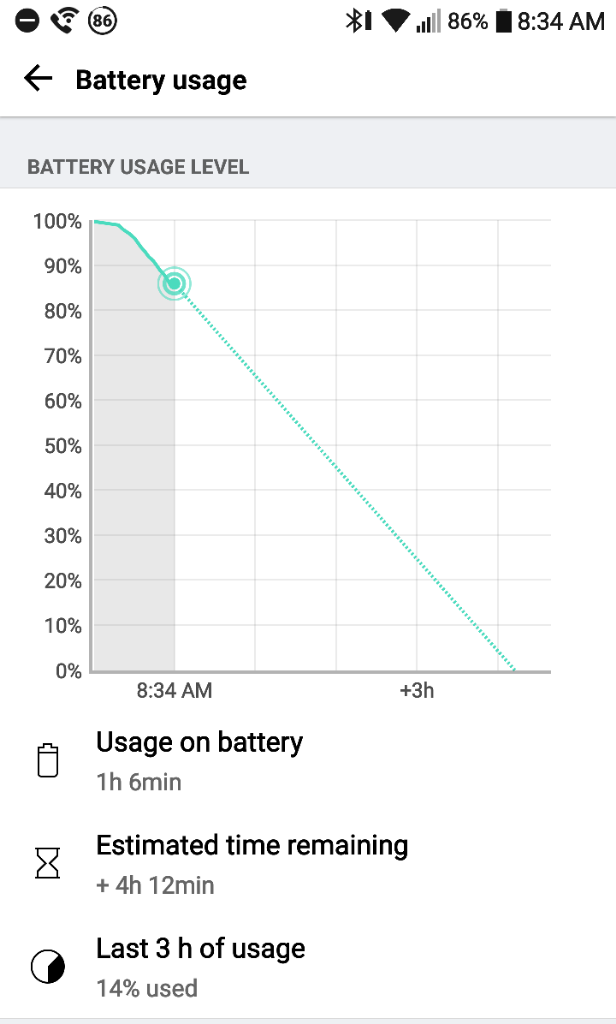

No new apps or networks, but after 2 months of consistent and excellent battery life, phone is suddenly consuming way more battery (like, 20% more) for basic tasks. It's also the first time I'm aware of the battery heating up during use.
Thoughts? Troubleshooting?

This is weird - it gone over down 10% in the 10 minutes since I first posted. I've typically been getting 2+ hours sot with only a 5% battery drop. ?!

I've been looking for a bg app, but don't see anything running . But it's still used 43% battery in 2 hrs this morning! Normally that would use maybe 10% (at most) .
This is very NOT normal.
Nope. Currently backing up; seems like I have no choice but to try a reset, which is a major pain in the backside.
It has run PERFECTLY since I got it on November 2nd. Like, dream device. This has come out of nowhere, and I have no idea what the cause is to prevent it happening again. Grrr.
