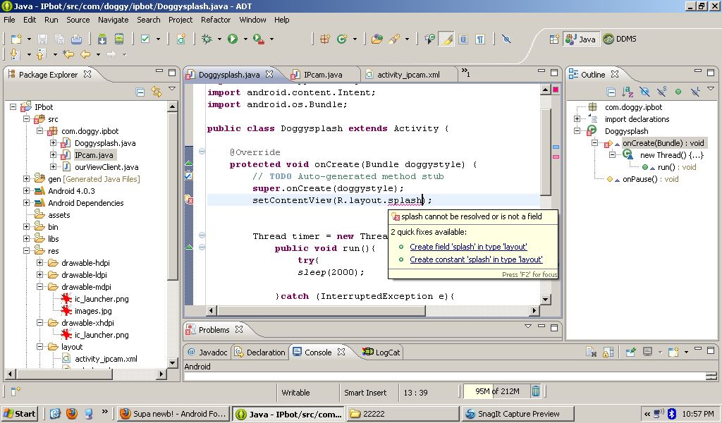

For now though i have hit a brick wall, please look at my screenshot and tell me why splash err shows up? i did something, but ctrl-z did not fix:(, when it started R was underlined, so i did quick fix import of r, but now splash? also similar happening with all other findviewbyid's.

As for your error with R.layout.splash, first, make sure the R.java file exists in the gen folder in your project. If it does, it *should* pick it up, but you can always force it by explicitly importing <base-package-name>.R
If it's not there, then you have an error somewhere in one of your resources.

also it was in the R file, it turns out i deleted it, then somehow got one without the ids, problem solved now thou,
